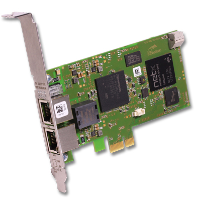

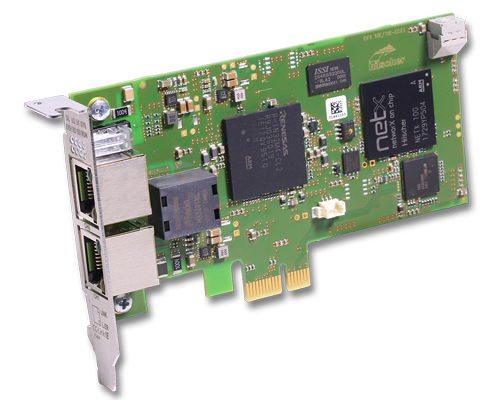

In an ever increasing plethora of CC-Link IE Certified products, the CC-Link Partner Association (CLPA), along with Hilscher announces the release of the Hilscher PCI Express card as well as a Low Profile PCI Express card for CC-Link IE Field. With the introduction of this product, Hilscher is expanding the range of its cifX PC card family of products.
Automation companies will be offered a PCI Express card as well as a Low Profile PCI Express card. The CC-Link IE Field cards are Intelligent Device Stations in the network and offer a fixed baud rate of 1Gbit/s. Acyclic communication can be realized via SLMP (Seamless Message Protocol).
The cifX PC cards are a unified standard supporting all Real-Time Ethernet and Fieldbus systems, like CC-Link, CC-Link IE Field and CC-Link IE Field Basic. The protocol stack will be executed on the PC card and exchange of process data with the host is done via Dual-Port-Memory or DMA (Direct Memory Access).
Thanks to the common Hilscher Platform Strategy, all PC cards use the same driver and tools – independent of protocol and card format. Always included in the scope of delivery is a complete software package, consisting of configuration tool, device drivers, examples and documentation.
