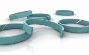

Wear rings
Wear rings, also called guide rings, are single-element bearings. Typically used in linear, reciprocating applications, they provide a robust method for guiding two elements over a long linear distance. Note that some wear rings are designed to wear out, serving as the sacrificial element in a design in which two surfaces rub against one another.
When created from PTFE or a high-modulus plastic, wear rings are suitable for many food and beverage applications because:
1. The material is biologically inert.
2. Wear rings are a single element, which means fewer places for microbes to grow.
3. Their design makes them easier to install and replace than bearings containing balls.
4. Their low-friction properties make them well-suited for applications with high loads but relatively low speeds, such as in industrial mixers.
Wear rings can be designed as sleeve bushings, flange bushings, or thrust bearings. When a flange is added to the wear ring design, it can be used as a guide for mounting or as a thrust washer to accommodate loading that is parallel to the machine shaft.
Design variations can be achieved by changing the type of plastic used. Fillers and additives improve performance — for example, increasing heat resistance or reducing friction. Plastic sleeve wear rings can be self-lubricating and are also lightweight.
