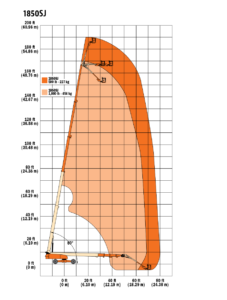

The working envelope of a boom lift includes all combinations of accessible height and outreach of the platform. These combinations directly influence the stability and strength requirements of the machine.
In 2014, JLG Industries, Inc. introduced the 1850SJ, the world’s tallest straight boom lift, with its envelope being controlled by sensors.

An envelope control system is the primary means of controlling the stability of the machine; it restricts the working envelope of the main boom. The envelope shape positions of stability and structural integrity can be controlled including the restriction of forward and rearward reach of the platform.
Each machine has its own envelope control. There are two ways to control the envelope of the main boom: mechanically and electronically. Mechanical limitations are typically reserved for smaller machines as straight booms can use linkages to restrict the envelope control. Small articulated booms can take advantage of the functionality of the machine to restrict the envelope.
Envelopes that are limited electronically are more prevalent on larger models, especially those with a straight boom. The boom’s envelope is controlled electronically with sensors, whether they are length and angle sensors or load sensing devices. The sensors restrict the length of the boom based on its angle and vice versa.

With the addition of sensors, the boom positions are continuously measured, and the position is controlled within the predetermined envelope. The system uses two main boom angle sensors, a main boom length sensor and a main boom transport length switch.
The two main boom angle sensors measure the angle of the main boom relative to gravity and are continuously monitored for mutual agreement. The main boom length sensor measures the length of the main boom and is monitored for response to the main telescope command and for agreement with the fixed position length switch.
Violations of the main boom position to allowable envelope positions will result in reduced function speeds, a boom control system (BCS) warning light illumination and restriction of functions. The platform alarm will sound and the BCS light will flash with attempts to operate restricted functions. The machine will be restricted from leaving the transport position until the failure is resolved.
Components, such as tires and engines, can be sized for the lower weight the system provides. The sensors and control systems used also provide the operator with smooth operation of the vehicle. The systems can additionally run diagnostic tests and enhance productivity.
With the addition of envelope control, a boom lift gains the advantage of multiple platform capacities on the same machine giving a user selectable envelopes based on the desired platform capacity ratings.
