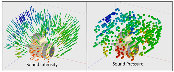

Sound pressure
Sound pressure, also called acoustic pressure is the local deviation from the ambient atmospheric pressure caused by a sound wave. It’s measured in Pascals (Pa) using a microphone. It is also be expressed in dB using a reference level of 20 x 10-6 Pa. The power of a sound wave goes up with the square of the pressure. In the US OSHA defines safe levels of sound pressure based on time of exposure. Daily limits set in OSHA standards include 90 dB of noise for 8 hours or 105 dB for one hour. Sound intensity can be confused with sound pressure. They aren’t the same. Sound intensity is equal to the mathematical product of sound pressure and sound particle (air molecule) velocity. Sound pressure is a scalar quantity and sound intensity is a vector, so sound intensity is a vector quantity.
