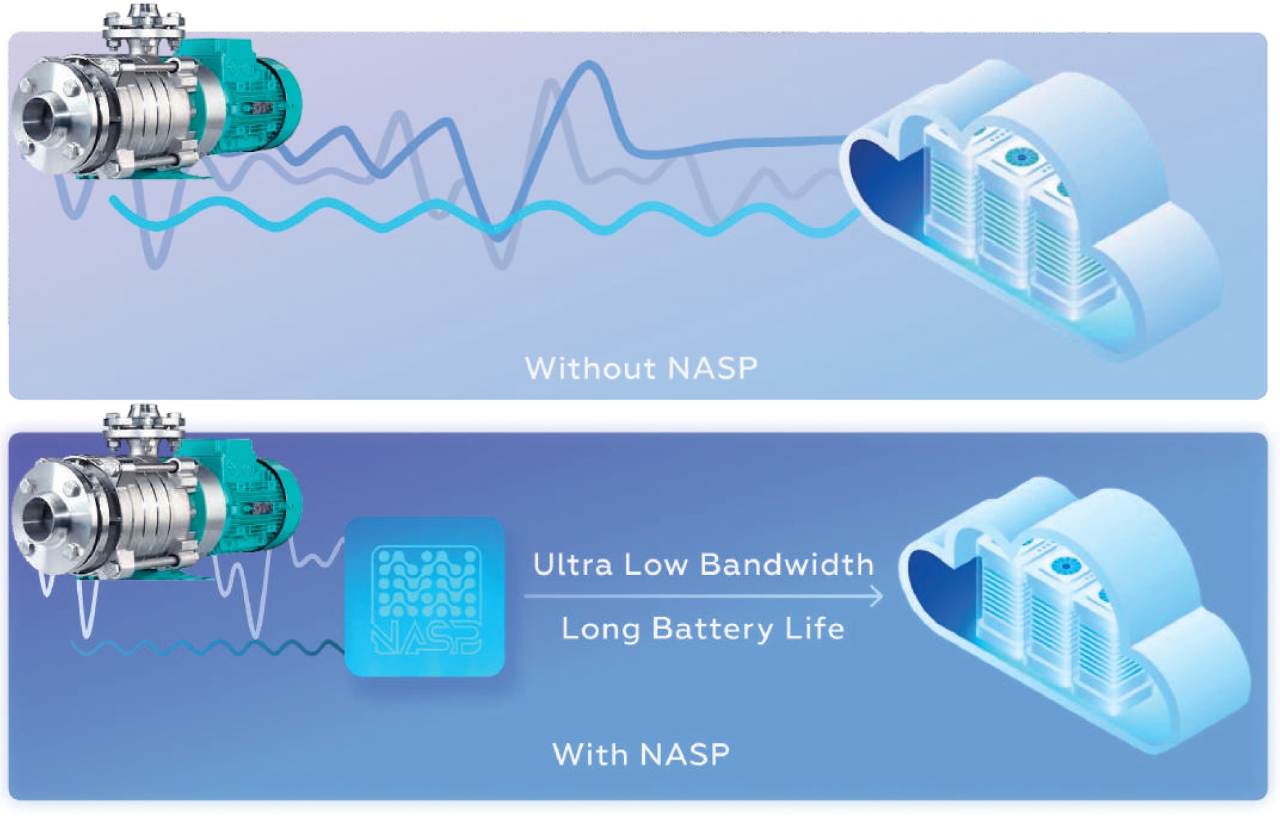

Another example of AI in accelerometers is the development of Neuromorphic Analog Signal Processing (NASP) technology to provide a solution to power consumption and computing latency tradeoffs by dramatically reducing data transfer requirements for applications like machine condition monitoring. An AI application has been developed to run on the NASP chip and locally analyze the data from accelerometers and other sensors used in machine monitoring, thereby reducing the amount of data that needs to be transmitted (Figure 4).
