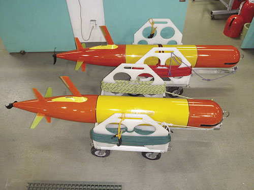

The All Motion EZSV23 controller is housed in a titanium pressure housing for protection while operating inside the Tethys Long Range Underwater Autonomous Vehicle as it operates under water or bouncing over the surface.

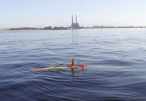

Each Tethys LRUAV is made from incompressible foam, which offers buoyancy so that the device doesn’t sink into the soft sea floor. The material also allows the unit to glide through the upper water column easily, hence using less electricity while it’s on a mission.
Extensive design efforts went into minimizing the propulsion power requirements for the unit, which is about 12 in. in diameter, 7.5 ft long, and weighs about 265 lb. Strategies included reducing drag through the development of a low-drag after-body, minimizing appendages, and developing control procedures to minimize induced drag. A custom propeller design and gearless propulsion motor optimized for efficient low-speed operations helped in these efforts. Of course, this unique design required a custom build.

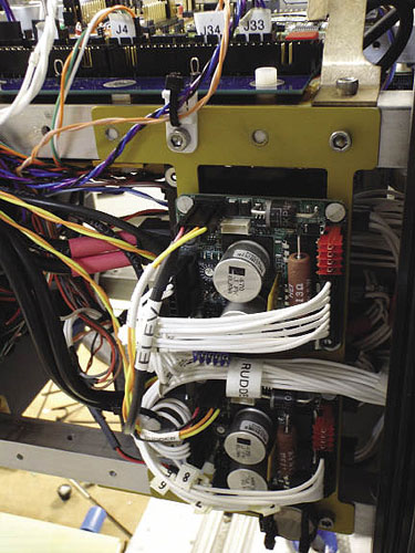

The All Motion EZSV23 Controller provides intelligent control of the five critical subsystems inside the Tethys underwater autonomous vehicle to make it useful for a variety of long-term scientific studies. Shown are the rudder and elevator controllers. The thruster and buoyancy pump controls are located on the opposite side. The fifth controller is in the front of the system.
The controller manages brushed or brushless dc motor systems in automation products within a short design cycle. These compact intelligent controllers measure 2.25-in.2; operate from 12-40 V through RS232, RS485, or USB-based communications; and were easy to integrate for the Tethys project.
A single, 4-wire bus links with up to sixteen 5-amp motors in a daisy chain format. Because commands can be delivered from any serial terminal program or from the EZServo/Stepper Windows application, you can make a brushless dc servo motor move intelligently in less than half an hour. Plus, the device is capable of stand-alone operation, and can be set up to execute a preset string of commands upon power-up.
Between the five subsystems, the LRAUV exercises nearly every available operating mode provided by the controllers except for slaving. When this amount of control is coupled with power control (the EZ Servos are powered down when not actively controlling a motor) it highlighted additional areas the engineering team could explore, such as commanding a negative encoder value without changing position immediately following a power cycle.
