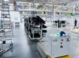

Mercedes-Benz, a globally recognized automotive manufacturer, is renowned for its innovative technology, craftsmanship, and luxury design. At their state-of-the-art automotive factory in Ludwigsfelde, over 70 AGVs move automotive parts to the assembly line. These AGVs transport everything from heavy engines to smaller electronics across distances ranging from 300 to 800 meters. Each AGV is equipped with an onboard Programmable Logic Controller (PLC) from Siemens or Schneider Electric, which ensures their efficient and safe navigation.

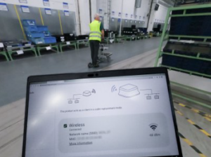

Mercedes-Benz provided key information, such as floorplans, to HMS’ wireless experts. Using this information, HMS first conducted a predictive site survey to determine the optimal placement and number of access points required. HMS then visited the factory to verify the accuracy of the survey and make any necessary adjustments.
Mercedes-Benz used the updated predictive site survey to install the required power outlets and network cabling. Once the required infrastructure was in place, HMS returned to install and configure the Anybus Wireless products before verifying that the installation worked as planned.

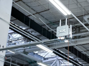

The wireless infrastructure uses Anybus Access Points powered by Anybus PoE L2 Managed Switches, with an Anybus Wireless Bolt II mounted on each AGV. The Anybus Wireless Bolts handle communication from the AGVs to the traffic control system and connect to the 12 different access points in the factory’s ceiling. As an AGV moves out of range of one access point, it transitions to the next, ensuring uninterrupted communication.
A critical aspect of the project’s success was the utilization of the 5GHz frequency band, while the Bolt II’s similarity to its predecessor also simplified the installation. Maximilian explains: “We wanted to use the 5GHz frequency band where we have four dedicated channels that didn’t interfere with our existing systems. It was also convenient that the Bolt II fits in the same hole as the original Bolt”.
Access Points were strategically placed around the factory to ensure seamless connectivity.
