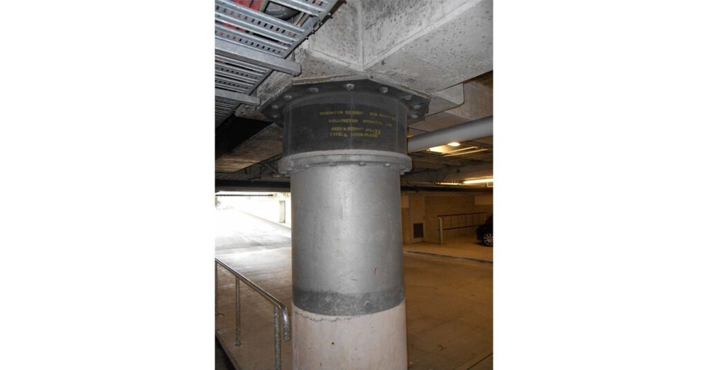

Lead-rubber bearings. Invented in 1974 by New Zealand’s Dr. Bill Robinson, the lead-rubber bearing is a modern example of base isolation, consisting of a lead core and alternately arranged layers of rubber and steel. In this design, rubber acts like a spring and remains soft during vertical loading.
Because the rubber itself features low stiffness, it can also flex sideways. To support high forces, the lead-rubber bearing is designed to feature high axial stiffness thanks to the steel layers. The lead core also absorbs energy caused by deformation and acts as a damping element. Flanges at both ends enable the lead-rubber bearing to be installed on existing structures, making this base isolation technique suitable for new and retrofit constructions.
