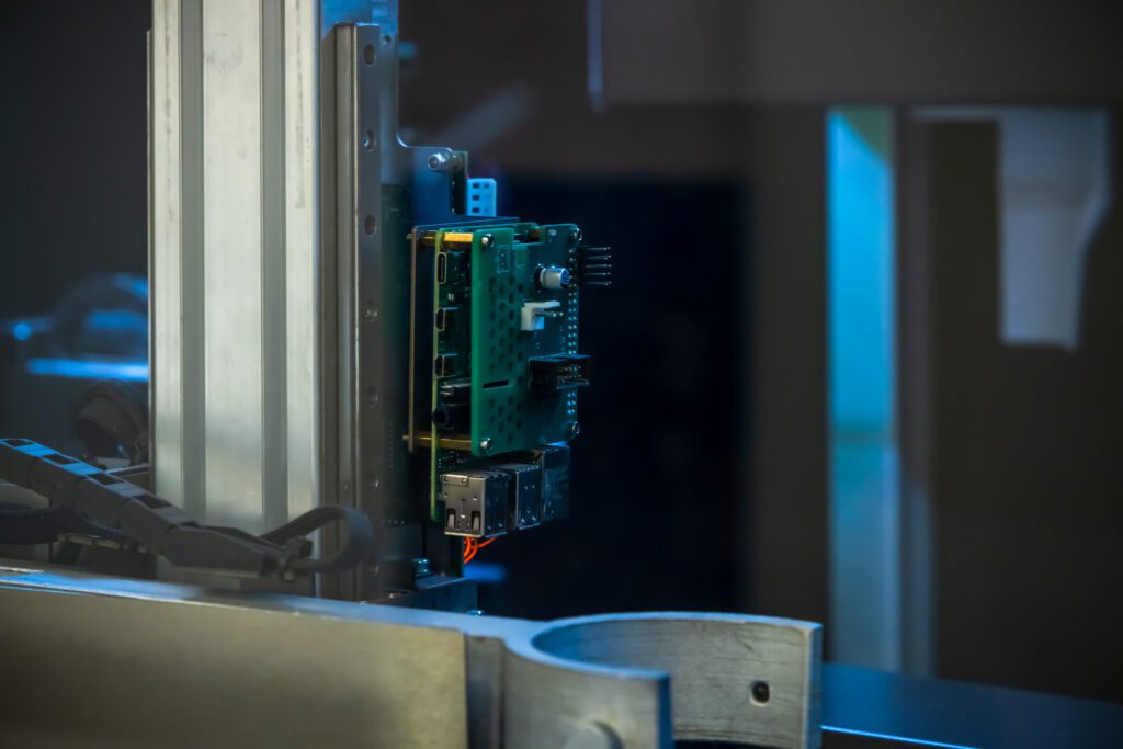

Shown here is the controller board of a robotic arm in an automated vending machine. Image: Dreamstime • Andrey Rykov

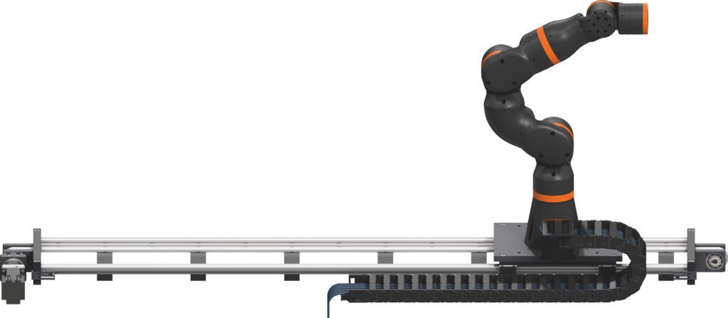

igus 6-DOF Robotic embedded-BDLC & electronics Link or ReBeL robots work as cobots and service robots in a wide variety of consumer-product processing applications. Image source: igus
