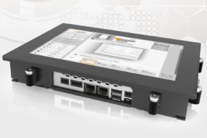

The modern multi-touch HMI is available with clear or anti-reflective glass, and is suited for premium machine designs. The touch screen reacts precisely and reliably even when operated with thick leather gloves. Gestures such as zoom or swipe provide an intuitive user experience. The Power Panel C50 is available in widescreen format in four different sizes from 7.0″ to 15.6″.
This Power Panel has a compact design, minimal installation depth and an intelligent cable outlet arrangement, making it an easy-to-mount space saver. With no hard disks, fans or batteries, it is also maintenance free. The front of the panel provides IP65 protection, suitable for harsh industrial environments.
It has a range of integrated interfaces, including POWERLINK, Ethernet and USB. I/O modules, axes and safety components can also be connected directly to the panel. There’s no need for additional controllers.
The Power Panel C50 suits running mapp View HMI applications. With the mapp View software package, B&R offers direct access to the wide world of web technology from the engineering environment. Automation engineers have the tools they need to create powerful and intuitive HMI solutions. There is no need to deal directly with HTML5, CSS and JavaScript technology. mapp View is based entirely on web standards, ensuring optimal viewing on any device. Content of multiple screens can be customized for specific users or user groups.
