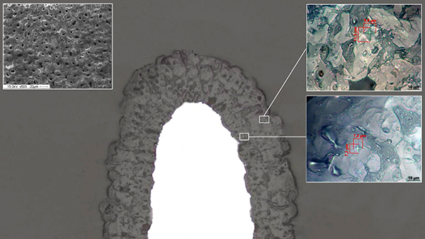

An example of a specific application. Cross section of a ca. 80 µm thick layer applied to the rounded edge (R=0.06 mm) of an aluminum workpiece (white in the image) with a variable microhardness of 894 HV (image below right) to 425 HV (image above right). The hard metal-ceramic bond strengthens and stiffens the thin aluminum component regardless of its geometric complexity. The image above left shows a SEM image of the surface topology.
