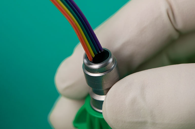

Master Bond EP41S-6: Tested for UL1203
Master Bond EP41S-6 is a two part epoxy system, which resisted each and every chemical without exception, and therefore is suitable for use in Class I, Division 1, Groups A, B, C, and D, and Class II, Division 1, Groups E, F, and G, in accordance with the NEC (National Electrical Code), NFPA 70 (National Fire Protection Association).

The optimal cure schedule for EP41S-6 is overnight at room temperature, followed by 6-8 hours of heat curing at 150-250°F. This compound features good flow properties, with a dielectric strength of 440 volts/mil for 0.125 inches thick specimens, making it ideal for sealing and potting applications for electrical feedthroughs across various industries.
