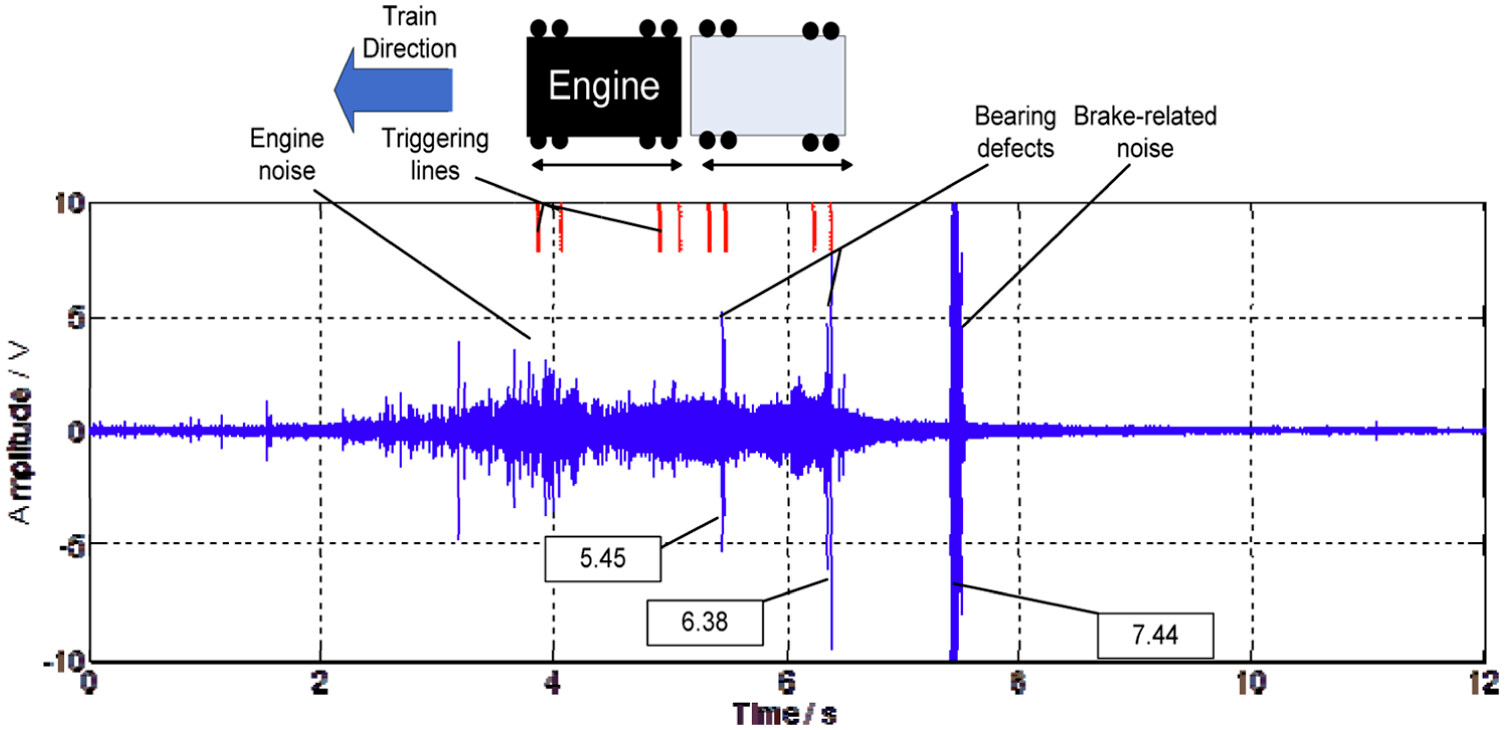

Acoustic sensors are being tested with sets of microphone arrays spanning about 25 feet of track length. By analyzing the acoustic emissions (AE) generated by the passing car’s bearing components, the system can identify which of the car’s components has an impending fault (Figure 3).
Figure 3. Researchers are investigating the use of acoustic emissions to assess bearing and other impending problems, but it’s an environmentally harsh and acoustically noisy measurement environment (Image: Sage).
Among the possible defects an acoustic-based system can identify — at least in theory — are bearing spalling or brinelling; loose, cracked, or broken components; peeling or smearing; wheels with flat spots; and lubrication failure. Without a doubt, it’s a long list of acoustic signatures to analyze and characterize in a challenging setting. It’s a lot more difficult than trying to assess bearing problems in a fixed-in-place industrial setting. There has been good progress here, and AI advances may help here, but complicating the problem is that every wheel that passes has a slightly different nominal signature.
