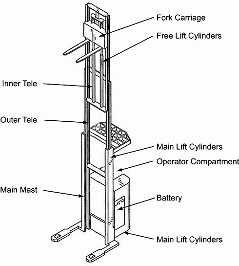

The company’s mechanical design engineering team studied everything from the elevating section to the tractor and operator’s area. They found that the hydraulic cylinders yielded the most significant manufacturing cost savings potential. First, they examined the current staging cylinder and brainstormed about how to reduce part count of the component without losing any cushioning or causing an increase in noise during staging. They used DFA to analyze the cylinder assemblies and determine the feasibility of each new design. Then, they used DFM to decide on the best course of action.
The lifting mechanism of a forklift truck involves two sets each of hydraulic cylinders and telescopic masts.
