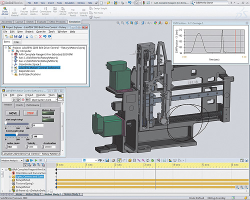

The concept of “virtual machine prototyping” connects motion control software and simulation tools to create a virtual model of an electromechanical machine in operation. Virtual prototyping helps you reduce risk and tackle design challenges for mechatronic systems by locating system-level problems, finding inter-dependencies and evaluating performance trade-offs.

The simulation capabilities of state-of-the-art 3D CAD tools can help in gathering the required information. Combined with the real-world trajectories from motion control software you can simulate real-world behavior and get the information without performing PhD-level math calculations.

In traditional design flows, control engineers usually couldn’t start implementing algorithms before a first physical prototype was built. Now, the integration of the LabVIEW NI SoftMotion and SolidWorks allows control engineers to design and validate their motion profiles as soon as a 3D CAD model is available, allowing engineers and scientists to create a virtual prototype of their cartesian motion system. By applying the motion profile developed with the high-level function blocks to a simulation-ready 3D CAD model, they can evaluate and validate the operation of moving parts and determine whether the motion profile performs as expected.

Define motor specifications based on the results of your motion simulation.
Several web-based motor-sizing tools have been designed to help sort through the thousands of choices, and some include motor data from multiple vendors. However, these tools are only as good as the inputs you provide. You can augment the tools by using features built into your CAD package to make more accurate estimates of your speed, inertia, and torque requirements.
Using realistic, multi-axis motion profiles to drive your simulation can provide more accurate torque and velocity requirements, which depend on the acceleration characteristics of your motion profiles and the mass, friction and gear ratio properties of the transmission. When evaluating simulation results, compare RMS values for torque and velocity with the rated performance curve for the motor, and compare peak values with the maximum velocity and intermittent torque limits.
