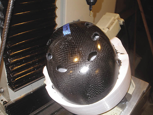

Artisent worked with Mike Murray, owner of Lakeside Design of Massachusetts, to design and build the fixturing and write the CNC programming code for the milling machine used in the manufacture of the helmets. This code included the 3D paths for drilling ventilation holes in the helmets.
Murray used a Tormach 1100 PCNC mill for all the prototyping work and to prove out the designs. The prototyping worked out so well that Artisent bought a Tormach mill and fourth axis for actual production.

The basic helmet form is removed and cooled and the edges are trimmed with a CNC lathe. Next, ventilation holes are added. The shell is mounted into a fixture custom-made for this manufacturing process.
Machining ventilation holes on the Tormach PCNC 1100 with 4th axis.
For the fixturing, Murray designed a 35° angle plate to be bolted to the bed of the Tormach mill. A fourth axis unit was attached to the mounting plate, which precisely rotated the work piece in a circle along the plane of the 35° angle. Finally, using a fused deposition modeling (FDM) process, Artisent made a holder out of polycarbonate plastic that matches the contours of the helmet. This plastic holder mounts to the fourth-axis. To mill the ventilation holes, an operator slips the shell into the polycarbonate receiver and starts the mill. Using a two-flute carbide mill/drill bit at 4500 rpm with a feed rate of 35 in./min, the mill completes a 3D contour of all the ventilation holes in a single helmet in approximately two minutes.
