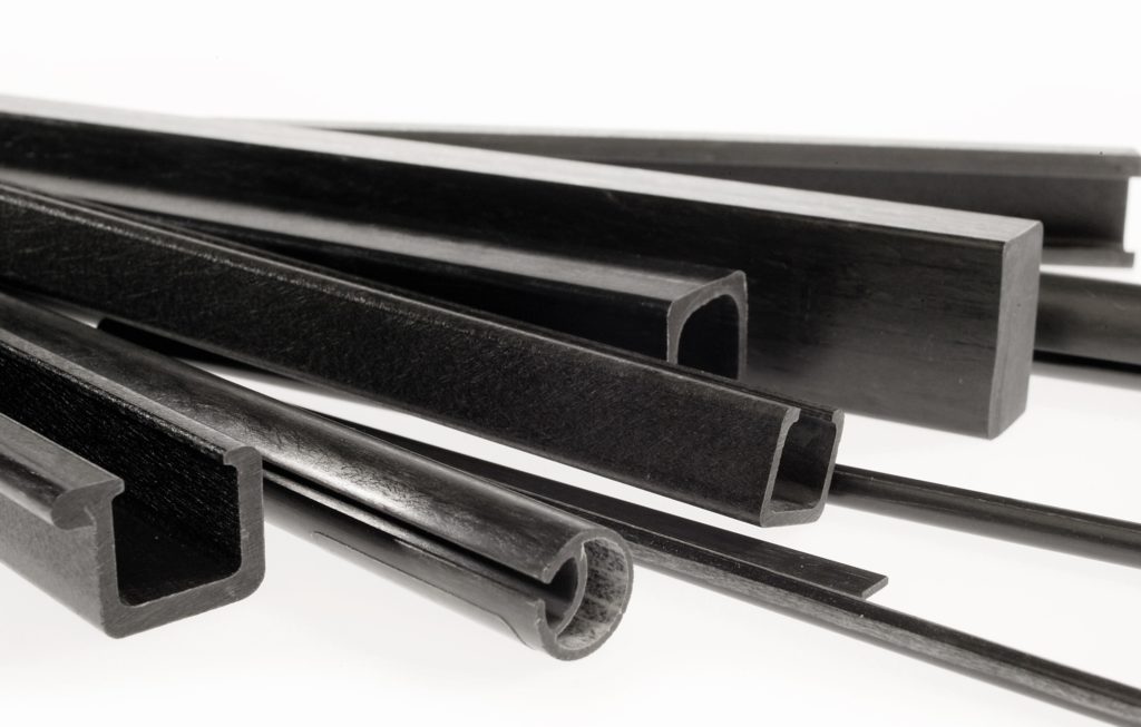

When selecting materials for a composite solution, many people become preoccupied with one decision: glass or carbon fibers? Although fibers provide the strength and stiffness composites are known for, resin choice is often overlooked. Here, Sami Pirinen, Chemist and Resin Expert at global composite manufacturer Exel Composites, explores how resins can affect a composite’s properties and why we should consider resin choice with the same significance as fiber.
A composite material’s key components are fibers and a resin. The fibers, typically made of glass or carbon, provide strength and stiffness, but if used alone fibers cannot be put in a shape or form where these properties can be used. Impregnating the fibers with resin followed by curing the resin allows us to engineer their strength, stiffness and light weight for a variety of applications, while adding even more benefits to the composite.
As for the resin selection, there are many choices available, as well as the option to incorporate resin additives, to meet the application requirements. Therefore, it’s very important to be aware of the differences between resins, and how their selection can affect a composite’s properties.
Complementing existing properties
All composites share common beneficial properties: strength, stiffness, light weight and resistance to harsh environments. Each of these features can be made more dominant by using a resin that complements them. To select the most appropriate resin, it’s first necessary to determine what its dominant feature should be.
A cost-effective way to make a weight-saving composite solution is to use an unsaturated polyester resin, which possesses relatively good mechanical, electrical and chemical properties. It can be adapted for a range of routine applications such as transportation, structural and construction profiles.
However, if an application requires a greater degree of stiffness or strength, then an epoxy resin is preferable. The bonding between an epoxy resin and the fiber is strong, which means higher shear loads can be transferred between fibers, giving the composite better strength values. Combined with the higher volume of fibers that the epoxy resin allows for, a composite with excellent strength and high stiffness can be made, which can be modified further to suit high temperature applications if required.
Alternatively, if a composite not only needs to be stiff, but also resistant to harsh environments, vinyl ester resins may be a better choice. The molecular structure of vinyl ester facilitates chemical resistance, so if a composite is destined for a marine environment or an industrial application where acids or alkalis are present, using a vinyl ester will improve the composite’s performance.
When producing composite profiles that need to be assembled using screws, the composite needs to be robust to prevent cracks and breakage. This can be achieved through structural design, but selecting a suitable resin allows for a simplified structure and reduced costs, making the composite suitable for a wider range of applications. Polyurethane is extremely tough in comparison to unsaturated polyester, making it ideal for such applications.
Selecting a resin that will complement the most valuable features of a composite will enhance your composite’s performance and lifespan. However, improving existing properties is not the only advantage gained from taking the time to choose a suitable resin.
Adding new properties
Resins can also add entirely new properties to a composite solution. Resin additives can be incorporated into the resin to achieve a range of benefits, from a simple improvement in surface finish or the addition of color, to more complex enhancements, such as UV resistance or antimicrobial and antiviral properties.
For example, since resins naturally decompose when left in sunlight, adding ultraviolet absorbers to resist UV radiation allows composites to achieve a better performance in sunny environments that would normally cause embrittlement and disintegration of the material.
Similarly, antimicrobial additives can be blended into a resin to prevent bacteria or fungi contamination. This is useful for any composite solution handled by humans, such as machinery, public transportation, and medical devices.
Additive influence
It’s important to note that, in some cases, the inclusion of resin additives can alter the properties of a composite. In some cases, for example, fire retardant additives are needed in such high quantities to work efficiently that you must reduce the number of fibers in the composite, reducing its strength and stiffness.
For that reason, it’s essential to discuss your resin choice with a professional. At Exel Composites we have over 60 years of engineering expertise, meaning we can help you to find a composite solution to meet your needs.
Resin choice is a vital part of creating a composite solution and shouldn’t be overlooked. Establishing the most important function of a composite and designing the resin to improve the composite’s ability to perform this function allows us to create a composite solution in which the fibers and resin work harmoniously.
