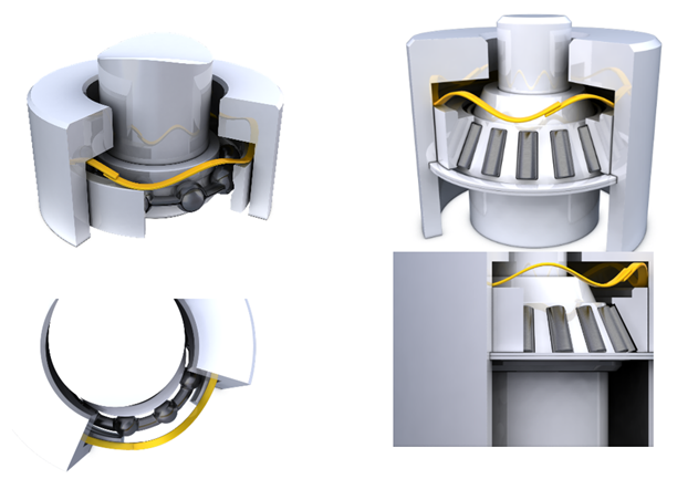

There are two main methods to preload a bearing. The first is solid preload, which is achieved by holding inner and outer races in place with a locking mechanism.
The more common, simpler, and less expensive method is spring preload, which is achieved by using a spring to apply a constant axial load on one side. A Smalley single-turn wave spring provides necessary preload force between the inner or outer races while also compensating for any tolerance stack-ups or thermal misalignments. Play is reduced both axially and radially, as depicted in the image below.
So what’s the big deal, why do we preload bearings?
Controlling play is necessary to maintain bearing functionality and longevity. Preloading a bearing provides constant contact between the bearing type (ball, needle, etc.) and bearing races. The sustained load provided by the spring eliminates axial and radial play, among other benefits. The overall goal of preloading is to prolong bearing life, and therefore, your application.
