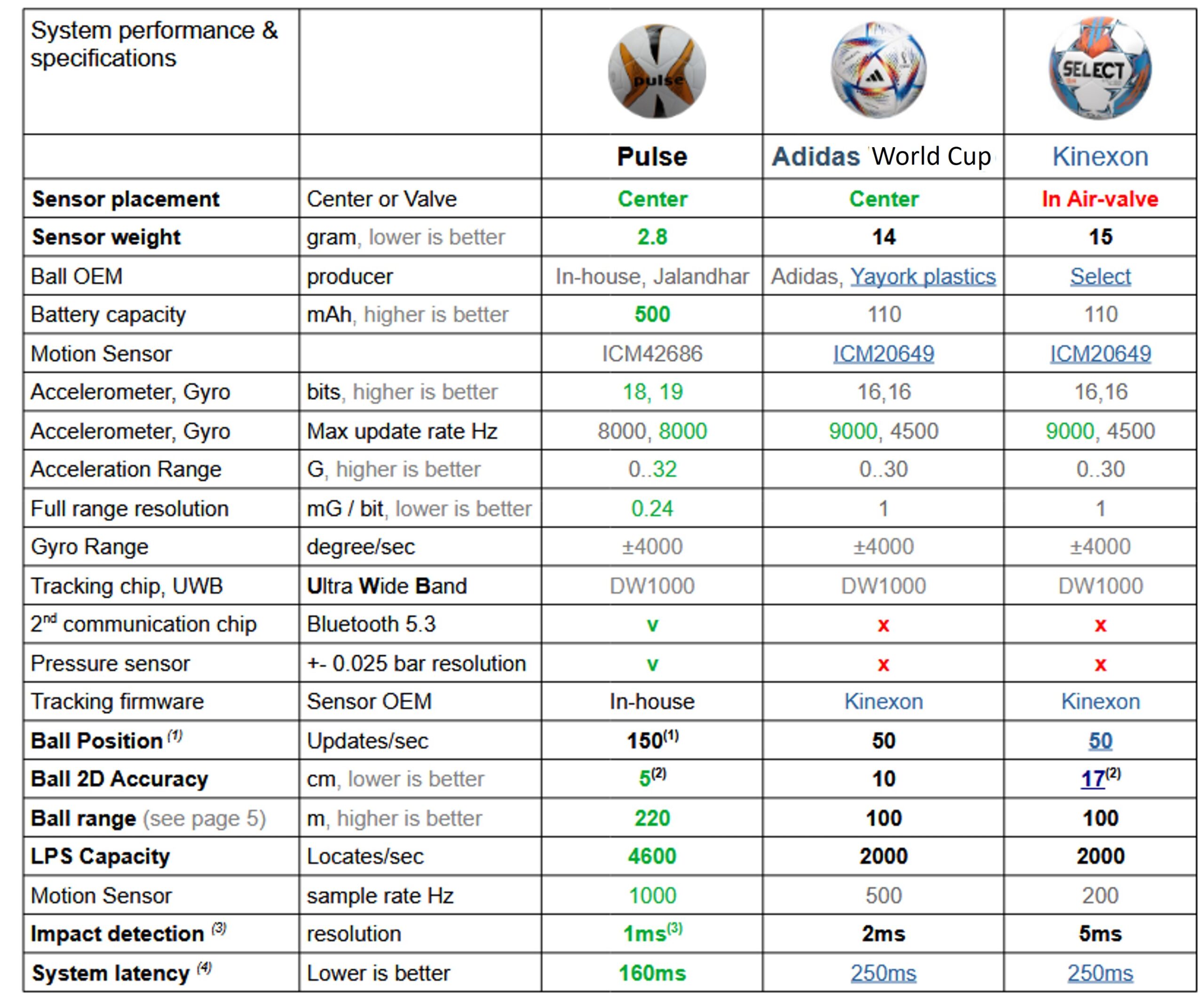

In AIRTLS PULSE design, the ball connects with UWB and Bluetooth technology to an anchor. Depending on the size of the field, an anchor would be required every 20 meters. Smaller, mobile anchors are used for tracking with the players having tracking units in their shin guards. The anchor connects to computers, servers, and the internet for data analysis. While all three versions of instrumented FIFA soccer balls use TDK InvenSense six-axis MEMS motion tracking sensors, the AIRTLS Pulse ball uses a newer generation motion sensor, as shown in Table 1.
Table 1. AIRTLS Pulse ball system exceeds the World Cup 2022 ball specifications.
The ICM42686 has a 20-bit analog-to-digital converter (ADC) that provides a 19-bit resolution for the gyro and an 18-bit resolution for the accelerometer. It turns out that 16-bit resolution was acceptable for the World Cup ball. However, with the newer generation sensor, the ball position can have 4,600 updates/sec, 5 cm 2D accuracy, 1000 Hz sample rate, impact detection of 1 ms resolution, and only 160 ms system latency. The motion sensing technology includes five distinct elements:

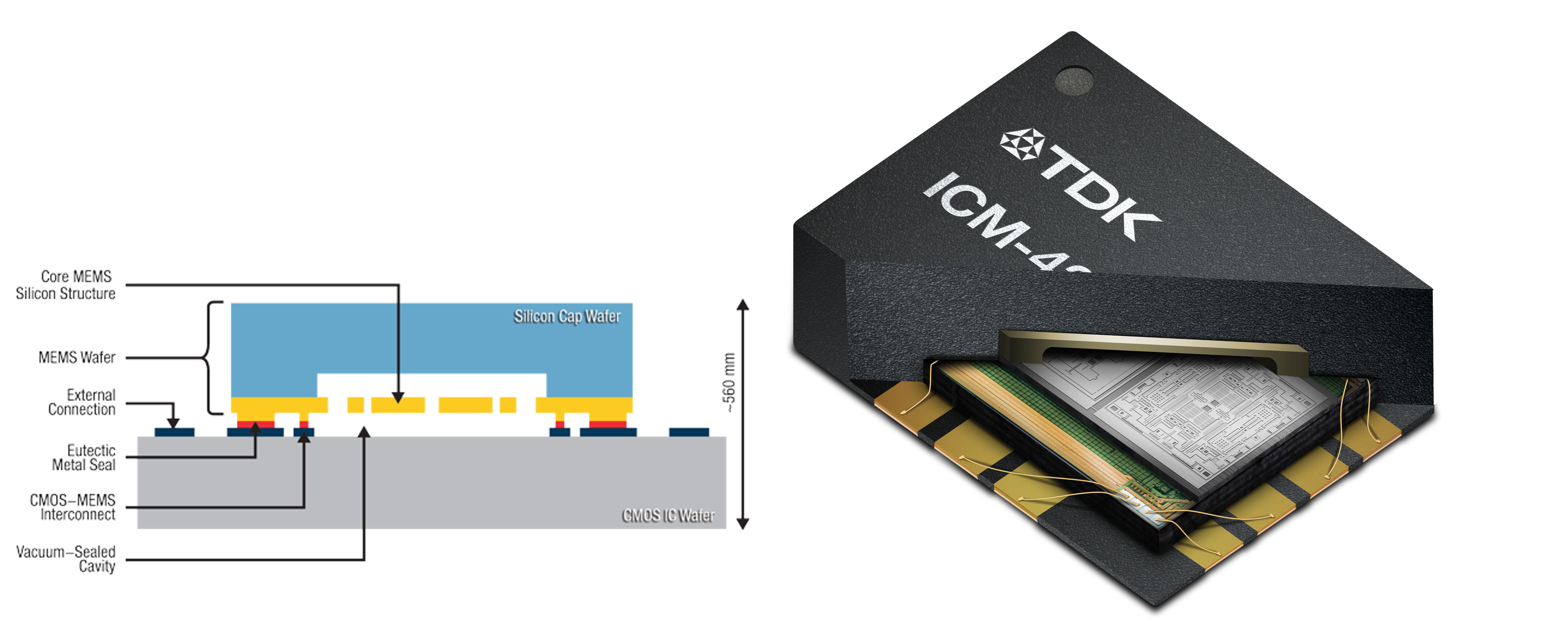

Figure 1 shows the MEMS sensor’s structure, including its packaging. In traditional MEMS fabrication, the complementary metal oxide semiconductor (CMOS) circuitry is attached to the top of the MEMS structure. In contrast, the patented InvenSense fabrication process enables direct integration of MEMS mechanical structures with standard CMOS at the wafer level.
Figure 1. The six-axis MEMS motion tracking system in the Pulse FIFA World Cup soccer ball consists of an integrated 3-axis gyroscope, a 3-axis accelerometer, and an associated motion processing engine in a 2.5 x 3.0 x 0.91 mm LGA-14 package.
