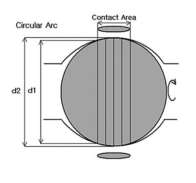

Shape of the grooves. The four-point contact design is, because of its shape, called a gothic arch. It eliminates any clearance that could lead to deflection and is, therefore, best suited for applications requiring maximum precision. Often found on larger spline sizes, this four-point contact increases the load capacity and rigidity so that this ball spline can handle a greater moment load.
Keyless cylinder nuts are suitable for small size compact applications.
Of the groove designs on the market, the standard choice is between balls that make contact with the raceway grooves at two points or at four points. A slightly elliptical groove design allows the balls to make contact at two opposing points but allows a bit of clearance on the balls’ sides that are perpendicular to the contact points. A change of shaft rotation direction may cause backlash of this circular arc type nut. Because there are larger contact area differences on a gothic arc, the inner part of the balls must rotate faster than the outer, which creates slippage and results in greater friction. For this reason, circular arc grooves are used for smaller, more friction sensitive ball splines.
