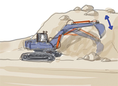

Much like a human arm with interconnected bones, muscles, and tendons, earth moving equipment components must harness a complex array of parts to perform in perfect synchrony. Key to an earth mover’s fluid movements is an array of hydraulic cylinders, located along the boom, arm and bucket, that act as actuators to convert hydraulic energy into mechanical energy. Filled with pressurized oil that transmits force to move a piston, each cylinder barrel (housing) is a seamless steel tube designed to resist fatigue from the very high number of operating cycles that it endures.
Earth mover with hydraulic cylinders on boom, arm, and bucket.

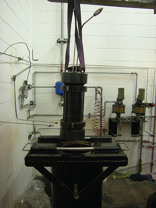

To prove out the performance and quality of their products, the Dalmine R&D center has been conducting extensive full-scale testing of its hydraulic cylinder products for many years. This process begins with detailed mechanical characterization and fracture tests on tube materials. Then artificial defects are manufactured on the external surfaces of full scale tubes by means of electro-discharge machining. The tubes are then pre-cracked to different depths, capped, and chilled to minus 20°C. Finally, they are pressurized with an alcohol water mix (aluminum filler bars are inserted inside the tubes to take up space and thus avoid extreme volumes of high-pressure fluid being released during bursting) and subjected to burst tests.
“With this ‘build and break’ test program we have been able to demonstrate the performance of our products to our customers in a way that’s close to the real service behavior of the components,” said Dalmine researcher Marco Spinelli. “But the test regimen is complex and quite expensive. We wanted to find out if numerical models could effectively replicate our experimental results, reduce our costs and save us time.”

Here is the traditional build and break methodology in action; Shown: a hydraulic cylinder in a burst test machine.
