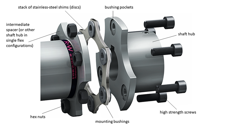

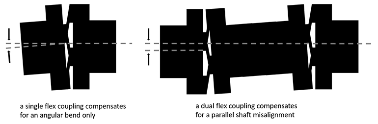

Flexible disc packs are comprised of thin sheet metal shims, stamped or laser cut in a ring shape with a series of mounting holes; normally 6-8 but more or fewer are also used, depending on the size of the coupling, with the smallest commonly using 4 and with any number of holes for the very largest sizes.  The shims are stacked together and held in place by bushings, and the resulting disc pack is bolted into the coupling system.  Misalignment compensation depends on the flexibility of the shims themselves, and generally the larger the stack, the greater the overall stiffness of the disc pack in terms of both torsion and bending.  Centering of the disc pack in the coupling can be accomplished by different means, with one common method being precision machined pockets in the adjacent mounting flanges which hold the disc packs concentrically in place by their bushings.  The disc packs are mounted to their respective hubs with the bolted joints alternating between the driving hub and the driven hub.  The portions of the disc pack bridging the distances between the respective bolted joints provide the flexibility and allow a single disc pack connection to pivot and compensate for an angular bend while transmitting rotation and torque.  A single disc pack is generally rigid in shear, meaning that it cannot compensate for misalignment between two rigidly supported shafts, unless used in conjunction with a second disc pack to make the opposite angular bend and complete the parallel offset.  The exception is when a single disc pack is used in conjunction with a self-aligning bearing, which replaces the second disc pack in providing the second angular freedom of movement.  The greater the distance between disc packs, the larger the parallel misalignment which can be compensated.

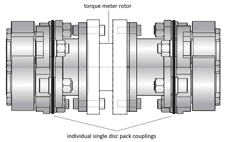

The stiffness in shear of a single disc pack provides one of the keys to smooth running at high speed.  Most flexible couplings have some level of softness in the radial direction, which means that centrifugal forces more easily deform the flexible element when rotating at higher speeds, leading to instability and vibration.  In contrast disc couplings have a unique ability among flexible coupling systems to hold all of their components rigidly within their rotational axes, including any spacers, drive shaft tubing or other components which might be mounted between the two flexible joints.  This makes them an excellent choice for high-speed balancing.  A further advantage of the radial stiffness of a single disc pack is its ability to support intermediate devices.  Most commonly this intermediate device is a torque meter, used widely in test stands and other applications requiring condition monitoring.  This allows the torque meter to become an integral part of the coupling system, held in concentric rotation by the radial stiffness of the single disc pack coupling on each of its mounting faces.

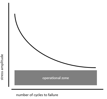

Also related to rotational speed is the number of bending cycles a disc pack can tolerate before failure.  Because they have no wear or moving parts, no abrasion occurs over the course of a single rotation, and misalignment compensation is accomplished by flexing of the sheet metal.  Steel components are generally considered to possess long term fatigue strength when able to withstand 107 load cycles of a given stress amplitude.  Because industrial disc couplings are normally rated for misalignment and torque conditions which can be withstood for at least this number of cycles, they are considered fatigue resistant for a service life approaching an infinite number of rotational bending cycles – key to their reputation for maintenance free reliability.
