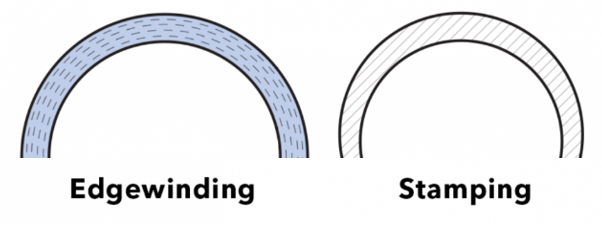

The significant improvement in load tolerance was due to how each spring was manufactured. Wave springs are manufactured by edgewinding, or coiling flat wire on edge, while wavy washers are stamped from flat-rolled steel sheets. Then the waves are formed in the stamped circle.
The difference in manufacturing results in wave springs having a circular-grain metallurgy, which increases the strength and stability of the material. Smalley’s retaining rings are also manufactured by edgewinding, shown below in Figure 3. Since the grain follows the direction of the coil, it provides better spring properties than if the shape were stamped and the grain only went in one direction.
