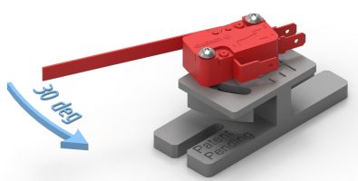

A new Limit Switch Mount, the LM-1, solves the long-standing problem of mounting a snap-action switch while also providing a large amount of adjustment. The mount accommodates both miniature and
standard snap-action switches. Specifically, it will fit snap-action switches with: #4 (0.112in/2.84 mm) or #6 (0.138 in/3.5 mm) mounting holes and a mounting hole spacing (R) of 0.910-1.07 in (23.1-27.2 mm). Most Standard and Miniature snap-action switches fall within this range.
Benefits:
• Innovative Design, Patent Pending
• Highly Adjustable, Provides 30° of adjustment
• Universal Fit — A single model accommodates most standard and miniature snap-action switches
• Simple Adjustment — Requires only a single hex key to adjust and lock – two sliding hex retaining nuts are self-captivated within unique arcuate and linear tracks
• Secure Positioning — When locked, switch remains securely in position
• Rapid Switch Swap-out — Mount remains in place while a switch is swapped out
• Versatile Design — Can be employed, without modification, in a variety of applications
• Time saving — Pre-engineered for off-the-shelf deployment
• Low cost — Single unit — $24.95 (Inquire about multi-unit pricing)
• Compact, small footprint
• Durable — Single-piece design molded from Nylon 12
