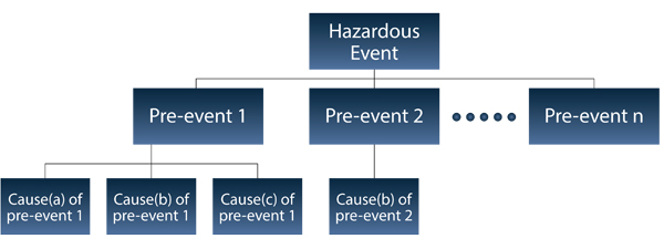

Various tools and standards can guide developers for each phase. For example, a Fault Tree Analysis (FTA) can be used for hazard analysis. The FTA analytical approach helps identify each hazard and trace its lineage to the root cause. The process for FTA is to define each hazard and list the preceding events that can lead to the identified outcome. By capturing each event in a systematic manner, a fault tree can be built for each hazardous event in a hierarchal manner starting from the root cause.
A Fault Tree Analysis can help guide developers.

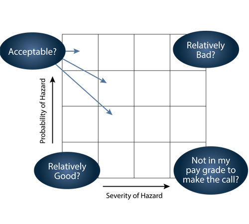

There is no predetermined level of risk that is acceptable, and there is no equation or regulatory guidance for acceptable risk. This decision is somewhat subjective, but must take into consideration the potential hazard and harm that can result.
Once the hazard and risk analysis are completed, the device can be classified based on the severity of the potential harm using industry specific methodology.
Hazard as a function of the probability and severity. The Hazard Matrix is representative of the challenges associated with determining areas of acceptability.

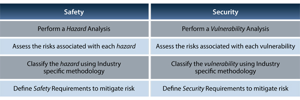

Similar to the development of safety software, security requires proactive management. However, instead of managing for hazards, security is about managing vulnerabilities and their associated risk. There are general guidelines and industry specific standards for cyber security that are starting to become more commonplace such as FIPS140, NIST 800-53, and IEC 62443 to name a few.
Differences between safety and security.
Also, consider the FDA non-binding guidance on securing medical devices throughout the product life cycle. Manufacturers are encouraged to boost cyber security measures by adding functions to monitor and detect vulnerabilities as well as update devices with software patches.
Even though there are many security standards, there are common themes among them that include identity management, authentication/authorization, detection, protection, secure communication, and mitigation. All of which can be boiled down to two security aspects: 1) how the device should protect itself, and 2) and how the device should be developed.
Developers have access to an array of hardware security features embedded in modern system-on-chip (SoC) architectures for device protection. Features such as high-assurance boot, root of trust, cryptography acceleration engines, secure key storage, and trusted execution environments can be leveraged to meet security requirements. Software protocols can encrypt to protect data at rest or in transit. And there are technical control standards for identification and authentication such as X.509 certificates and passwords. The specific security functions to build into the device will be defined by the results of a vulnerability and risk assessment.
As with safety, security requires a plan to manage the risk. However, for security, the goal is to manage the risk associated with each vulnerability, which requires a detailed assessment.

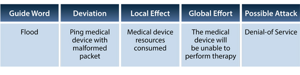

The objective of vulnerability assessment is to identify potential security concerns within the system. This calls for a comprehensive investigation of security threats and vulnerabilities. Tools such as the hazard and operability (HAZOP) analysis can be used to conduct vulnerability analysis. HAZOP uses guidewords for specific situations that are parsed into a list of intentions and deviations. The deviations are analyzed, and if significant, have a mitigation plan to reduce the risk.
HAZOP analysis example.
The following guidewords for vulnerability analysis are provided as an example: a) Probe – access a target to learn characteristics; b) Flood – access target incessantly to overload system; c) Spoof – masquerade by assuming the identity of a different entity; and d) read – obtain the data in device storage, etc. As further example, the guidewords are then parsed into a list to highlight the potential impact.

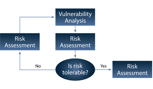

Upon completion of the vulnerability analysis, a risk assessment is required for each vulnerability. There are varying methodologies for determining risk including formulas; however, most agree, risk determination is a function of the threat, vulnerability, and severity.
Risk = Function [Threat, Vulnerability, Severity]
The goal is to understand the risk to determine if it is acceptable. The ability to determine risk is not always as straight forward as using a simple formula. As an example, for a vulnerability with a risk occurrence of 1%, should you factor in the impact of a determined hacker focusing on that single vulnerability 100% of their time? When determining risk, if the assessment shows that the risk is not acceptable, then risk mitigation is required and a new vulnerability analysis should be completed.
Determining risk.
The vulnerabilities should be classified using industry specific methodology. Many security engineers use High, Medium, and Low for vulnerability classification. Once the vulnerability and risk assessments are completed, then the requirements to mitigate the vulnerabilities can be defined.

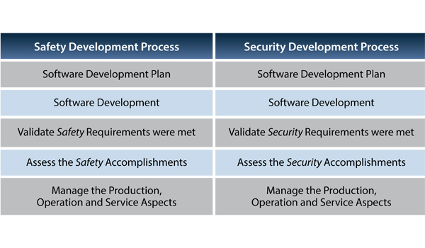

As with safety, the development of a medical device requires a plan to realize the software for the device and to validate that the vulnerability requirements were fulfilled. The defined processes must include a plan to service the device post production to address vulnerability issues as they are found.
Safety vs. Security Development Process.
With the increased scrutiny from regulatory authorities, cyber security is becoming an important consideration that must be met by device manufacturers. Fortunately, there is significant overlap between the development practices for safety and security, and it is vital to understand both the similarities and differences between the two principles. Doing so will make you, and your company better prepared to handle today’s safety and security needs, as well as what may come along tomorrow.
