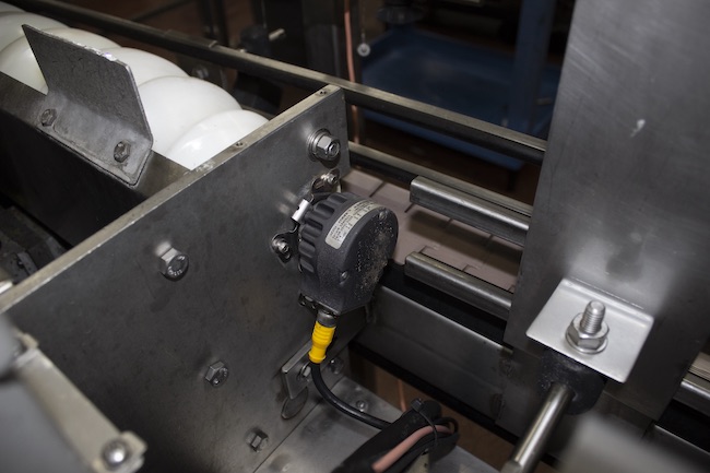

A model 25H encoder from Encoder Products is used in a packaging conveying application. The thru-bore construction means it can mount directly onto motor or drive shafts.

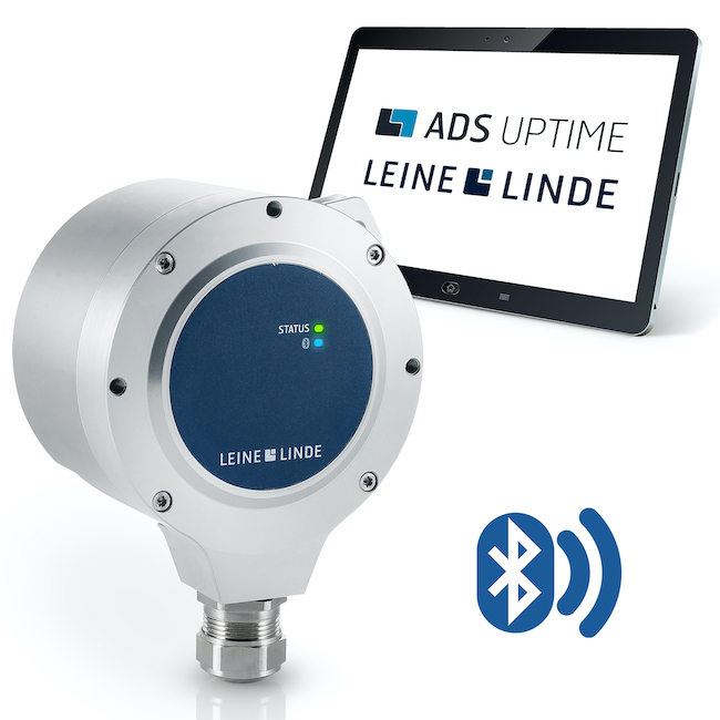

Another offering of this type is available in our Leine Linde brand encoders which can come with our Advanced Diagnostic System called ADS Uptime. This system monitors the key functions and conditions which affect the health of the encoder and provide this information through an existing hardline connection or over Bluetooth directly to a phone or tablet. This Bluetooth feature allows maintenance personnel to have easy access to view the condition of the encoder and even provides an easy-to-read overview of encoder health like a decreasing battery charge as you see on your phone. Once the encoder health reaches a certain threshold (say 20%), you’re provided a warning stating it may be time to do maintenance for this part allowing users to move towards a more predictive maintenance cycle.

The next generation of advanced diagnostic system is the ADS Uptime from Leine Linde. ADS Uptime is available for wireless service check-up via Bluetooth, as well as for system integration via OPC-UA, or both.
