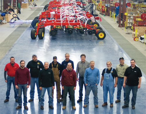

A 496 x 32-ft x 9-ft deep concrete-lined pit had to be constructed when the foundation of the building was laid. By February, 2015 the moving-floor assembly system, consisting of almost 1 mil lb of fabricated steel, was fully installed and operational.

The design uses a string of 25 × 10-ft wheeled carts, with a working surface of steel plates to support the tillage equipment and the workers performing the assembly functions.
