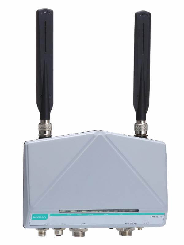

To meet this need, Moxa has introduced its new AWK-4131A-US-T outdoor industrial AP/bridge/client featuring an IP68-rated weatherproof housing coupled with support for ultra-fast 802.11n and 2X2 MIMO (Multiple-input /multiple-output).
Moxa has introduced its new AWK-4131A-US-T outdoor industrial AP/bridge/client featuring an IP68-rated weatherproof housing coupled with support for ultra-fast 802.11n and 2X2 MIMO (Multiple input and output).
To meet this need, Moxa has introduced its new AWK-4131A-US-T outdoor industrial AP/bridge/client featuring an IP68-rated weatherproof housing coupled with support for ultra-fast 802.11n and 2X2 MIMO (Multiple-input /multiple-output) to improve throughput up to 300 Mbps, even under conditions of interference and multi path propagation. Tolerant of vibration, moisture and wind, it is optimized for installation in railways, bridges and marinas, as well as critical industrial applications including high-resolution IP video surveillance.
“The Industrial IoT continues to evolve, converging multiple systems into single networks, and making reliability all the more critical since a single AP failure can affect availability on a large scale,” said Nick Sandoval, Wireless Product Marketing Manager. “Our AWK-4131A-US-T delivers extremely reliable wireless networking to the harshest, most demanding environments so that industrial users can benefit from Wi-Fi’s cost savings, flexibility, and scalability.”
Designed specifically for harsh environments, the AWK-4131A-US-T can be used in an exceptionally wide temperature range of -40° to 75°C (-40° to 167°F). It is the industry’s first weatherproof access point to offer dual isolation on power and RF signals, greatly enhancing its resistance to the negative effects of electromagnetic disturbances. The unit also features Moxa’s AeroLink Protection for superior wireless redundancy and reliability. AeroLink Protection provides a smart failover method with fast recovery time and scalability, making it easy to enable multiple layers of wireless connection protection to maximize mission-critical system uptime and keep the entire network live for continuous transmission.
Since the AWK-4131A-US-T supports 2×2 MIMO 802.11n, it is able to transmit at high speeds up to 300 Mbps. When used as a wireless client, it supports Moxa’s Turbo Roaming for superior wireless roaming performance, specifically 150 ms out of the box without requiring a separate controller. The AWK-4131A-US-T also supports Dynamic Frequency Selection operating in the 5GHz band, which makes more wireless spectrum available to minimize interference and maximize bandwidth.
The Moxa AWK-4131A-US-T is certified by the Wi-Fi Alliance for maximum interoperability and is compliant with all major standards and approvals.
