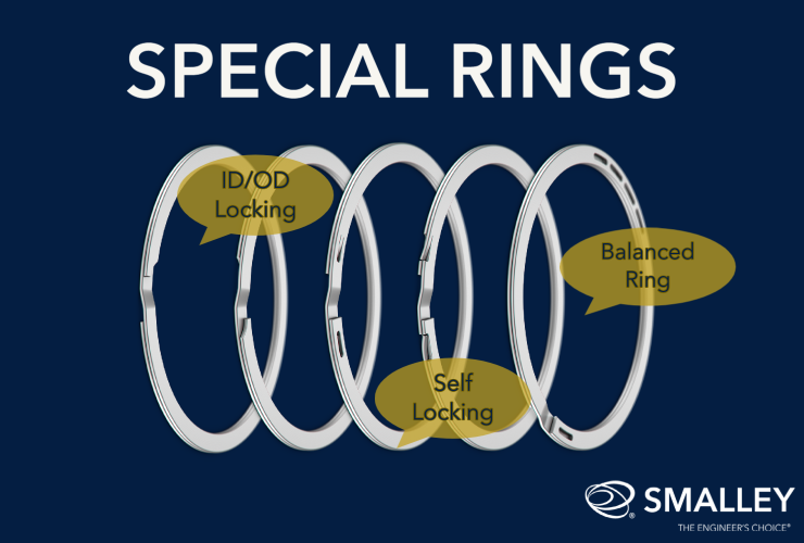

What is a self-locking ring and how does it work?
A self-locking ring is a custom retaining ring feature that increases the ring’s rotational capacity, ideal for applications that have high rotational requirements.
The self-locking feature consists of a tab and a slot that interlock to prevent the ring from expanding. The tab lines up with a slot on the mating turn such that when the ring is installed into the groove, the tab seats inside the slot.
This feature allows the ring to function properly at speeds far exceeding the rotational capacity of a standard retaining ring. The self-locking feature makes it possible for the ring to operate at high speeds, withstand vibration, function under rapid acceleration, and absorb a degree of impact loading.
The self-locking tabs can be designed on the outside diameter (for external retaining rings), on the inside diameter (for internal retaining rings), or on the centerline of the ring.
Installation of the self-locking ring follows the same process as installing a standard Spirolox retaining ring. Both tabs must be fully secured in their respective slots on the mating turn. Proper installation can be visually inspected.
Balance-Critical Applications
When the balance of your assembly is critical, such as a rotor, Smalley offers a balanced ring design.
What is a balanced ring and how does it work?
A balanced ring is a custom feature that may be added to reduce the residual imbalance of the ring itself. By reducing the residual imbalance of the ring, this helps reduce the overall imbalance of the entire assembly.
Smalley’s balance feature statically balances the retaining ring. A series of slots, opposite of the gap end, are placed such that the ring’s center of gravity is statically balanced along its axis of rotation.
Tamper-Proof Applications
If you require a locking mechanism in your assembly, Smalley offers an ID/OD Locking Ring.
What is an ID/OD Locking Ring and how does it work?
An ID/OD Locking Ring is a retaining ring that operates in an internal and external groove simultaneously, creating a concealed, tamper-proof assembly.
The ID/OD lock is beneficial for applications that require two mating components to be held together in an assembly, but also rotate freely.
There is a groove in both components that traps the ring, locking the ring on both the inner diameter (ID) and outer diameter (OD); hence, the term ID/OD lock. The ring cannot be removed, and the two components cannot be disassembled without damaging the ring and assembly.
Typically, the groove diameter in the housing is oversized to accommodate the ring diameter as it expands over the shaft. The ring is first installed loosely into the housing groove, and then the housing is pushed onto the mating component (shaft). The ring ID expands to the shaft diameter, then snaps into the shaft groove. The ring will then cling tightly to the shaft groove.
The oversized groove in the housing allows the two components to rotate relative to each other, while the ring keeps both components locked together. The ring is hidden from view, keeping two pieces connected in an easy and inexpensive manner that is aesthetically pleasing.
