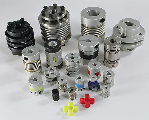

Flexible they may be, but couplings are not a onesize-fits-all proposition – far from it, in fact.
Few drive train components are as deceptively simple as a coupling. Two rotating shafts, a coupling to connect the two, and all systems are go – or seemingly so. But unless couplings are specified properly, operations can sputter – sometimes to a halt. In addition to speed and torque transmission, another factor that must be considered is misalignment among connecting shafts.
Enter flexible-shaft couplings. While their rigid counterparts are specified when precise alignment is required, flexible couplings are employed when axes are at a slight angle (up to three degrees of angular misalignment) or slightly displaced, either as a result of tolerance build up or the rigors of operations, including bearing wear or structural deflection.
Depending on operations, misalignment may be lateral, axial, angular or skewed. Angular misalignment occurs when shaft centerlines intersect to form an obtuse angle. Lateral misalignment, by comparison, results from lateral displacement among parallel centerlines. Skewed misalignment refers to combinations of angular and lateral misalignment, and axial misalignment to the movement of shaft members toward or away from one another, often as a result of thermal expansion or contraction. Although conditions may vary, the outcome is invariably the same: The greater the misalignment among shaft members, the less efficient the motor is in generating speed and torque. Misalignment also contributes to premature wear, including broken shafts, failed bearings and excessive vibration.
Flexible-shaft couplings accommodate misalignment while transmitting torque between shafts through a flexible element sandwiched between a pair of hubs. Depending on the configurations, the couplings also may impart exceptional torsional strength, torsional rigidity, and vibrational damping, as well as low moment of inertia.
While the import of these attributes varies among operations, growing demand for high-speed, high-efficiency processing is driving greater demand for high-torque, high-misalignment, low-inertia couplings with minimal compromise to torsional stiffness.
Operations requiring precise motion control, such as those in packaging, bottling, and visual scanning and inspection, also require couplings that exhibit zero backlash. These zero-backlash, flexible-shaft couplings ensure accuracy and repeatability by minimizing play among components. If the motor shaft turns 90 degrees, so too does the ball screw shaft, and without lag time. Zero-backlash couplings are often used in conjunction with servomotors, encoders and resolvers where speed, precision, and accuracy are critical. Due to the performance requirements, these couplings are often referred to as servo couplings or encoder couplings.

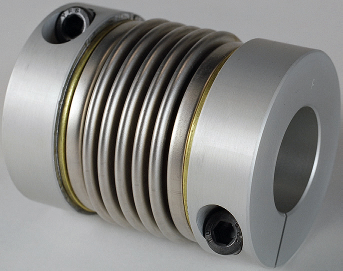

bellows-coupling
These bellows couplings are joined by a thin, flexible wall made of stainless steel or nickel. The wall’s composition limits torque capacity, but accommodates angular, axial and parallel misalignment. The wall’s sensitivity makes this coupling well suited to applications involving fine instrumentation. Its torsional rigidity  fits aggressive servo-driven applications.

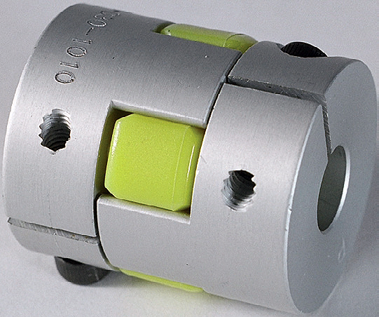

In addition to their damping abilities, curved jaw couplings generally exhibit large torque capacity. The couplings generally consist of a pair of metallic hubs and an elastomer insert known as a “spider,” whose hardness can be customized to meet performance criteria. When joined, a jaw from each hub is fitted to the spider’s lobes, with the jaws’ curved profile reducing deformation, thereby limiting the effects of centrifugal forces during high-speed operations.
jaw-couplings
Jaw couplings have strong damping abilities, while curved jaw couplings have large torque capacity. The couplings generally consist of a pair of metallic hubs and an elastomer insert. When joined, a jaw from each hub is fitted to the insert’s lobes, with the jaws’ curved profile reducing deformation, thereby limiting the effects of centrifugal forces during high-speed operations.
While jaw couplings can accommodate speeds of 40,000 rpm or greater, they have difficulty accommodating large amounts of misalignment, particularly axial motion. Additionally, large angular or parallel misalignment can create loads on bearing that surpass those of most servo couplings.

Rather than a center disk, bellows couplings are joined by a thin, flexible wall made of stainless steel or nickel. The wall’s composition limits torque capacity, but readily accommodates angular, axial and parallel misalignment. Due to the wall’s sensitivity, the bellows is well suited to applications involving fine instrumentation. Owing to its torsional rigidity, arguably the greatest among flexible couplings, the bellows also provides a superior degree of precision in rotation. As such, it is well suited to aggressive servo-driven applications.

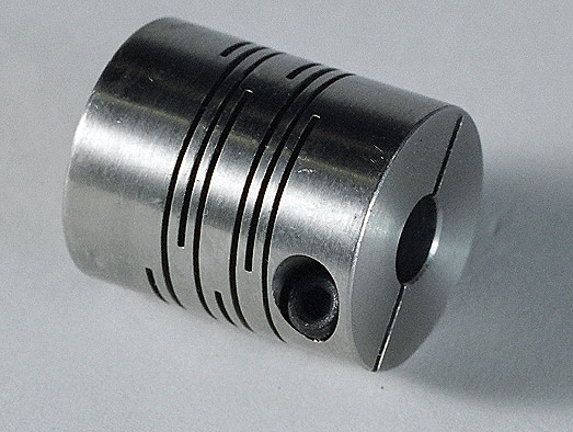

Beam couplings typically come as single or multiple beams. Using a single continuous cut that completes several rotations,
the single-beam coupling can accommodate all types of misalignment, although it performs best with angular misalignment and axial motion.
Beam couplings, like disc couplings, are available in two formats, in this case single and multiple-beams. Each is of a single-piece configuration that transmits torque with zero-backlash, and both include a network of spiral cuts to accommodate misalignment while transmitting torque. Employing a single continuous cut that completes several rotations, the single-beam coupling is sufficiently flexible to accommodate all types of misalignment, although it performs best with angular misalignment and axial motion. It is less successful accommodating torsional loads, a circumstance that can compromise accuracy.
As its name suggests, the multiple-beam coupling consists of two to three overlapping beams, a configuration that allows for shorter beams and, by extension, greater torsional rigidity, with little compromise to flexibility. The overlaps allow the beams to perform in parallel, thereby increasing torque.
