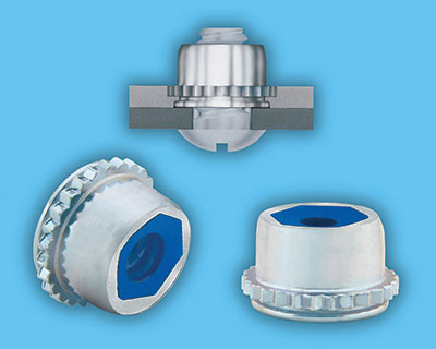

PennEngineering1 self-clinching locknuts
Self-clinching prevailing torque locknuts integrate a nylon hexagonal element offered as a locking mechanism option.

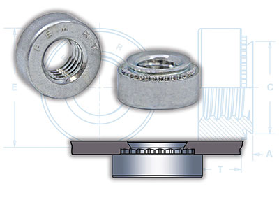

PennEngineering2
Self-clinching free-running locknuts designed with a modified thread angle provide a vibration-locking feature.
Self-clinching prevailing torque locknuts with nylon inserts generate torque resistance using a plastic insert as the locking element.
The insert is added during manufacture into the self-clinching body of the nut on the screw exit side (with the inner diameter of the insert approximately at the screw pitch diameter). As the screw enters the insert, the resulting interference at the major diameter creates prevailing torque. A major advantage of this locking method is the ability to significantly reduce the chance of conductive debris forming from the repeated removal and re-installation of a screw. These, too, can offer up to 15 cycles of thread-locking performance.
In contrast to prevailing torque types, all-metal self-clinching free-running locknuts will require tightening against a bearing surface for the locking mechanism to function.
A modified thread formation on the loaded flank of these fasteners provides the vibration-resistant locking feature and allows mating screws to spin freely during the attachment process until clamp load is induced during the screw-tightening process. The applied clamp load then engages the locknut’s vibration-resistant locking feature, which locks the mating screw in place. (If the clamp load, is removed for any reason, the nuts no longer will provide any torsional resistance to rotation.) Locking feature reusability will be unaffected by the number of on/off cycles.
