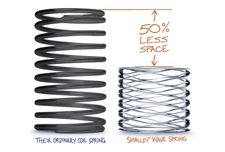

Wave Springs Save Space
The key advantage of using a wave spring is in the axial space savings. Whether it is a static or dynamic application, wave springs may be the ideal solution where space is a constraint.
The apparent difference between a wave spring and a coil spring is the height. A wave spring can provide the same force and deflection as a coil spring but in considerably less axial space. Wave springs have up to a 50% reduced height, mainly because of the following two design features:
(1) Flat Wire
Coil springs are typically made of round wire, while wave springs use flat wire. Flat wire takes up less vertical space than round wire, which contributes to the reduction in work height.
(2) Waves
Just as the name implies, a wave spring has multiple waves per turn. The wave design contributes to the load output of the spring. In the image below, we have a flat wire coil spring, a traditional coil spring, and a wave spring, respectively.
Because a flat wire coil spring has a thinner cross-section in comparison to the coil spring, a taller free height is required to achieve a similar load output. On the other hand, a wave spring also has a thin cross-section, yet has the lowest free height. This is due to the unique Crest-to-Crest design, which allows for similar spring rates to a coil spring, but with axial space-saving capabilities.
