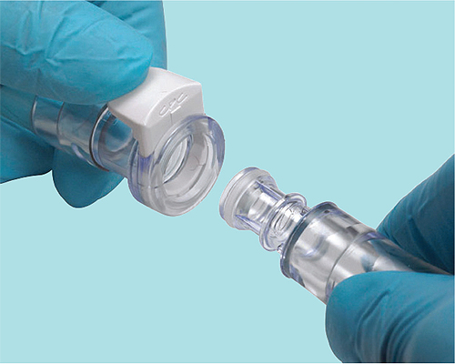

Begin by considering the safety of the patients and health care professionals who will be using the connectors. Connectors need to be easy and intuitive to use so there is no danger of leaks, spills, or in particular, misconnections.
In the past, the luer was a simple, universal design that provided an acceptable connection for many applications. However, today’s escalation in the number of tubes and connections in medical laboratories, hospital rooms, and operating rooms has increased the danger of misconnections. Regulatory and reporting groups such as the Food and Drug Administration (FDA), the Institute for Safe Medication Practices (ISMP) and The Joint Commission (TJC) have all reported patient injuries or deaths arising from misconnections.
Due to concerns over the proliferation of luer connectors, a series of new small-bore medical connector standards is being developed by a work group of the International Standards Organization (ISO) and the International Electrotechnical Commission (IEC). The ISO 80369 series of standards will define non-interchangeable connectors that will affect connector selections for a range of medical device applications. In the meantime, work with a company that understands these standards and has developed products to answer these concerns.

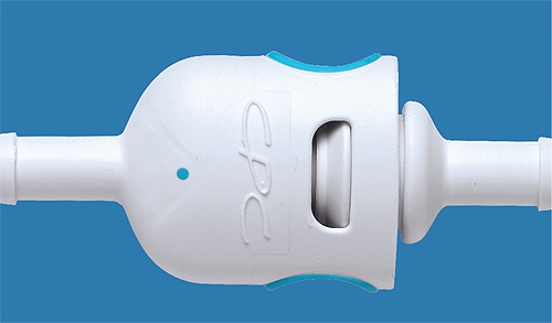

Fitting type – The most popular styles of hose connection are the single and multiple hose barb. Single hose barbs work well with softer tubing such as silicone rubber. However, connectors with multiple, sharp, well-made barbs, free of parting lines, provide a more secure connection over a range of tubing types.
Valve options – There are many styles of valves, and their flow rates and pressure drops vary. Connectors with integral valves prevent spills upon disconnection and prevent air from entering the system. Connectors with integral precision flush-face valves are considered true “dry-break” connectors and should be selected when there is a critical need to avoid any spills, contamination, or the introduction of air upon connection.

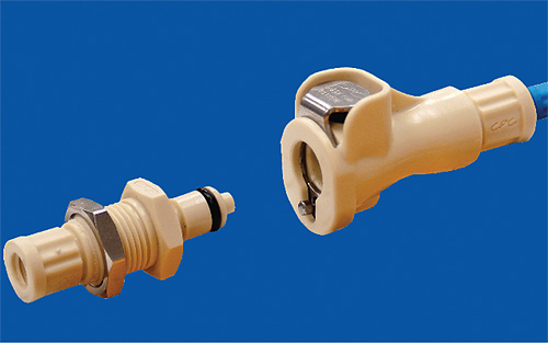

Mounting options – In some applications, a connector is mounted to the back, side, or front panel of a machine. Metal may be preferred for strength and a higher-end appearance; however, in most applications, plastic provides a robust, cost-effective solution.
