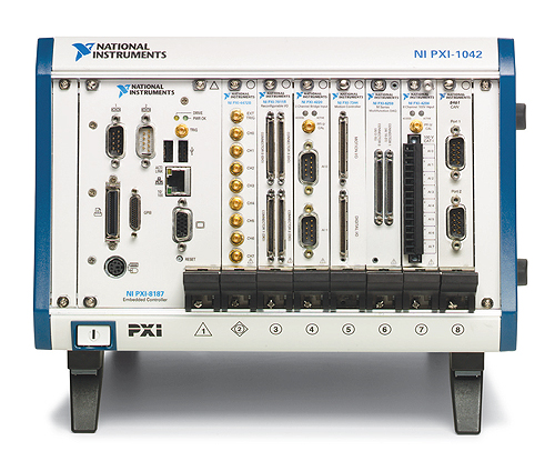

national-instruments-pxi-1042
The PXI platform is composed of chassis, controllers, and I/O modules.

PXI Platform
PCI eXtensions for Instrumentation (PXI) were developed to bridge the gap between desktop PC systems and high-end VXI and GPIB systems. The PXI Systems Alliance, with more than 200 members, maintains this open standard, and in 2006, passed the PXI Express specification to deliver PCI Express data transfer technology to the PXI platform.
Based on CompactPCI, PXI incorporates instrumentation extensions and more rigid system-level specifications to ensure an open yet high performance specification for measurement and automation. The benefits of PXI-based DAQ systems include rugged packaging that can withstand the harsh conditions that often exist in industrial applications. PXI systems also offer a modular architecture, which means that you can fit several devices in the same space as a single stand-alone instrument, and you have the ability to expand your system beyond the capacity of a desktop computer with a PCI bus. One of the most important benefits PXI offers is its integrated timing and triggering features. Without any external connections, multiple devices can be synchronized by using the internal buses resident on the backplane of a PXI chassis.

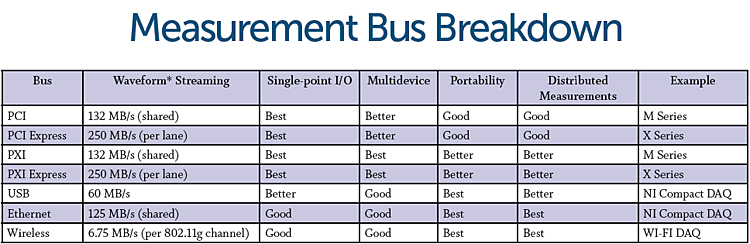

measurement-bus-breakdown-2
This table shows a bus-selection guide based on application requirements with example NI products. Based on these five questions, you can use NI’s selection guide for the most common DAQ buses to choose the right option for your application.
*Maximum theoretical data streaming rates are based on the following bus specifications: PCI, PCI Express 1.0, PXI, PXI Express 1.0, USB 2.0, Gigabit Ethernet, and Wi-Fi-802.11 g
