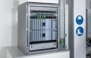

The Siemens Simatic Rack industrial PC manages the 5G core network infrastructure.

The setup includes Siemens Simatic Rack industrial PC controllers that manage the 5G core network and the radio access network (RAN) equipment in order to translate digital signals to the radio units. In the Siemens facility, automated guided vehicles (AGVs) are equipped with 5G routers, receiving signals from the radio units that communicate where the AGV needs to transport parts.
