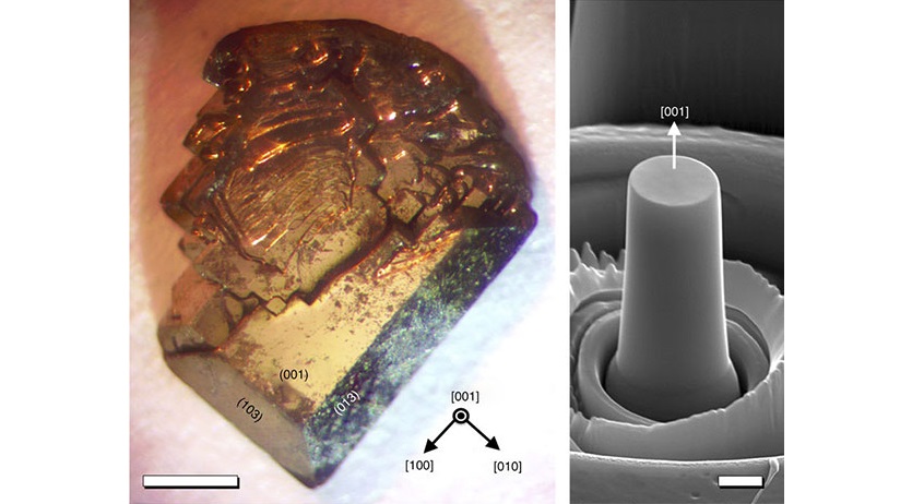

The researchers created micropillars of the material through single crystal growth followed by focused ion beam milling, and then subjected them to mechanical compression testing. They found a recoverable strain that can exceed 13 percent.
“This was a fantastic and gratifying result,” said Paul Canfield, a senior scientist at Ames Laboratory, and a Distinguished Professor and the Robert Allen Wright Professor of Physics and Astronomy at Iowa State University. “It fully confirmed our suspicions about CaFe2As2 offering a new mode of achieving superelastic effects and greatly expands the number of materials that may offer similar or even greater behavior.”
