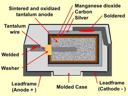

solid tantalum capacitor
Tantalum capacitors are one of the three types of electrolytics. The others are aluminum and niobium. All electrolytics are polarized devices whose anode (+) acquires an insulating oxide layer when voltage is first applied. This dielectric layer is quite thin, a characteristic that makes for high capacitance in a small package. An electrolyte covers the surface of the oxide layer to serve as the cathode (-).

To increase the surface area, tantalum capacitor anodes are often sintered or etched. This has the effect of boosting the capacitance still more. One type of high-capacitance tantalum capacitor is constructed by sintering and pressing tantalum powder into a pellet, which forms the anode. The oxide layer that becomes the dielectric is tantalum pentoxide and the cathode is generally made of a solid manganese dioxide electrolyte.
