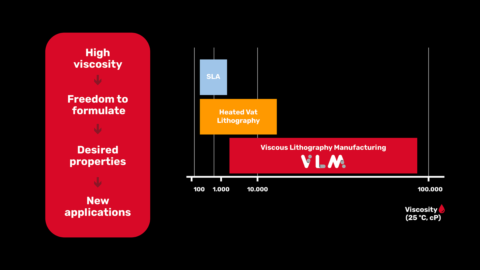

VLM is a patented lithography-based 3D printing process that laminates thin layers of high viscosity resins onto a transparent transfer film, producing high-performance parts rapidly and affordably. What distinguishes VLM from other resin technologies on the market is its ability to process resins 50x more viscous than the industry standard.

Without a strict low viscosity constraint, chemical companies have the freedom to formulate, as a whole new set of ingredients and modifiers can be added in the resin to achieve the desired effect on thermal and mechanical properties. VLM processes resins that obtain 3x the amount of impact resistance for rigid materials and a 200% increment in tear strength compared to industry-standard formulations.
