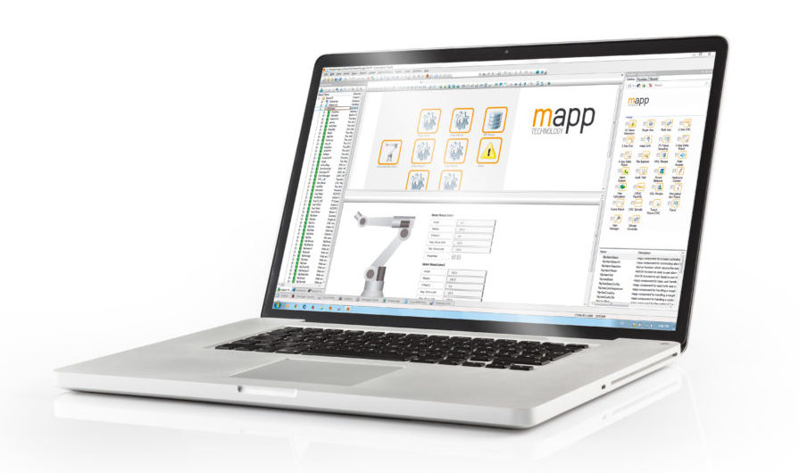

B&R has expanded its portfolio of modular mapp software components … so now, mapp RoboX and mapp Teach make it faster and easier than ever to get robotic systems configured and ready for operation. mapp RoboX controls any kinematic system with up to 15 axes. Developers get design freedom … yet the robot is simple to parameterize, with visualization and diagnostics already onboard. This saves time in development and during operation.    For the next step there’s mapp Teach, which provides intuitive teach-in functionality to define and manage the robot’s movement sequences and quickly get it going. mapp technology consists of individually encapsulated blocks that streamline development of new applications.    The components provide basic functionality with graphic configurability — cutting development times by an average of 67% … and all mapp components are connected via mapp links. Each mapp component retrieves the data it needs from other components using a client-server model.

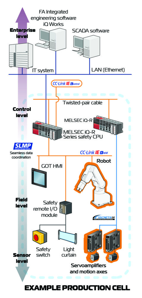

Consider still another example: Mitsubishi Electric Pak/iQ offerings for the packaging industry include integrated robotics and servo and PLC programming with one piece of software. Onboard analytics help operators avoid unplanned shutdowns; machine learning and continuous-tuning algorithms optimize servo performance. A typical setup might include a robot controlled via a MELSEC iQ Platform … with a Q series PLC and integrated robot controller on the same rack. Then communication between robot controller and PLC CPU is across that rack for top speed and throughput — and simplified robot-cell setup. Networking connects other components such as inverter drives and dedicated safety controllers.
Integrating robotics with other machinery allows top overall equipment effectiveness (OEE) by going beyond simple handoffs. The trend is towards complementary control, motion, robotics, and data management. Image courtesy Mitsubishi Electric
