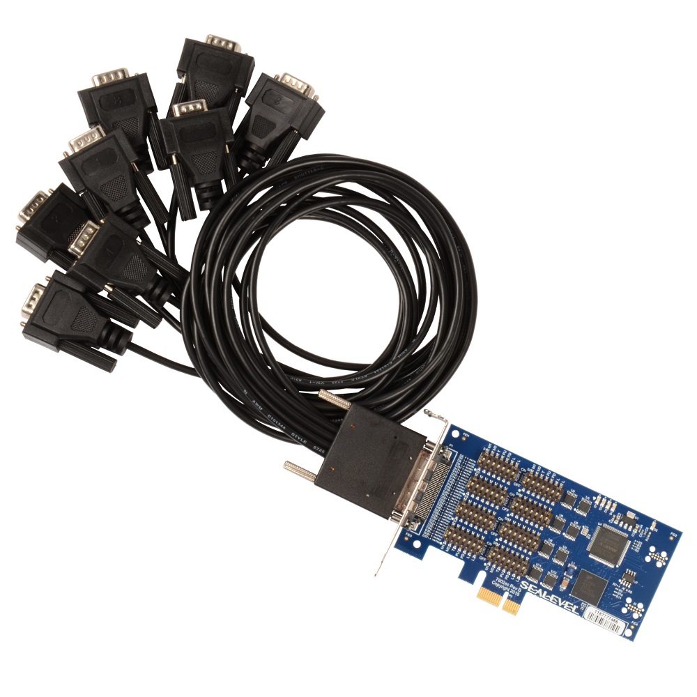

D-sub connectors attach to cables and to boards. Figure 4 shows a 15-pin solder-cup version of a D-Sub connector while the ribbon cables in Fig. 1 connect by being pressed into the connector pins. Figure 5 shows a board that inserts into a PCIe slot to add eight RS-232/485 ports to a desktop computer. The board’s specification page refers to the eight 9-pin cable connectors as “DB9.” Sorry, but it’s DE9. The “E” side connector, mostly used for 9-pin serial and 15-pin VGA, was developed last. Thus, it’s out of sequence relative to the others.
Sealevel systems serial port board
Figure 5. This serial-port board from Sealevel Systems adds eight ports to a desktop PC. The data sheet refers to the eight DE-9 cable connectors as DB9.
