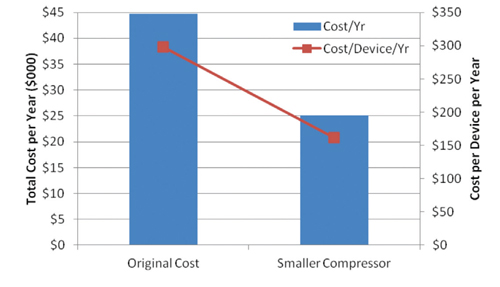

Total cost for pneumatic solution per year = $44,737
Cost per pneumatic device per year = $298
Even with a large 200-hp compressor cost per device is extremely low, bene?ting from the large scale of deployment. If a 100-hp compressor could be used instead costs can be cut further, as shown in the following chart.

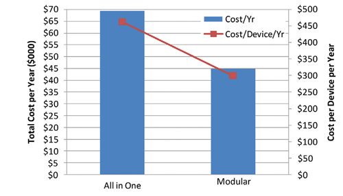

Cost of Electrics:
Annual cost at full load = $4,320
Annual cost at idle = $5,040
Annual operating cost for 200 actuators = $9,360
Replacement cost for actuators = $60,000
Total cost for electric solution per year: $69,360
Because of the large scale of deployment, replacement costs of actuators increase the annual system cost, making electric actuators impractical. The solution needs a productivity improvement to make it worthwhile pursuing.
Conclusions
In this instance, pneumatics proved to be the more economical alternative. Compressor utilization is more efficient because of the higher number of pneumatic actuators deployed. Electric actuator replacement costs drive up the electric system costs. Even with a modular electric actuator design, costs are substantially above pneumatic.
