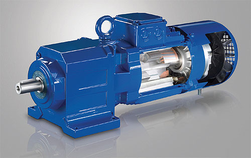

The PMSM (permanent magnet synchronous motors) fulfills the requirements of the pending IE4 (Super Premium Efficiency) classification. An environmentally friendly range of motors, it uses an efficient rotor design that integrates embedded permanent magnets made from the rare-earth material. Its design reduces heat losses from the rotor by 100%, total losses by approximately 25%, and increases total efficiency by 10% or more. These synchronous motors are efficient under partial load conditionsand rated operating conditions, have a higher power density, produce higher torques, and reduce weight. Available in ventilated and non-ventilated configurations, its power range from 0.55 kW to 15 kW and operate on 380 V to 500 V power supplies.
