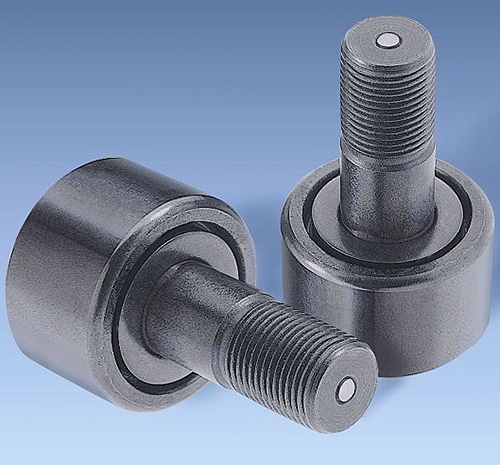

YONKERS, NY — Graphite Metallizing Corporation has announced that GRAPHALLOY® high temperature cam followers outperform ordinary grease or oil-lubricated cam followers in high temperature applications.
GRAPHALLOYCam
GRAPHALLOY® cam followers do not contain oil or grease to harden, burn up, contaminate or wash away. They are designed to handle moderate loads and speeds up to 100 RPM. They provide reliable performance in temperatures up to 750‚° F (400‚° C).
GRAPHALLOY® cam followers also perform well in low temperatures environments of -100° F (-73‚° C) and below, and in wet or submerged applications.
GRAPHALLOY®, a graphite/metal alloy, is a uniform, solid, self-lubricating material. GRAPHALLOY® cam followers will not deform under load, maintain dimensional stability and provide a constant low coefficient of friction for improved wear.
GRAPHALLOY® cam followers are especially suitable in applications where maintenance tasks are cumbersome, difficult or impossible to perform.
