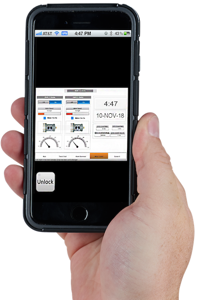

The best HMI display may not be a unit designed for fixed installation on the factory floor, but instead is often a mobile device, such as smartphone or tablet. The use of mobile HMI connectivity is increasing throughout industry, enabled largely by HMIs able to natively support remote access through browsers or dedicated mobile devices. Operators and maintenance personnel often appreciate the flexibility of monitoring and even controlling their systems from a handheld interface (Figure 3).
Image of a mobile HMI app displayed on a smartphone. The AutomationDirect C-more HMI units, whether they have a display or are headless, support remote and mobile display connections.
Therefore, there is often less of a reason to have a local HMI display. Or, designers can include one local HMI display for use if needed, but otherwise design their systems with one or more headless HMIs designated to support remote locations.
Depending on the control system network architecture, a headless HMI can be located almost anywhere. Many times this would be right at a machine and protected within a control panel, but it could also be any other convenient factory floor location or computer server room.
