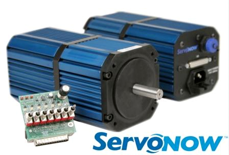

Bison's integrated brushless ServoNOW™ servo system for single axis applications was designed to meet basic motion needs by limiting programmability and using simple positioning and speed control applications. This state-of-the-art design reduces the amount of time and money spent on overall set-up and installation.
All input and output functions of the ServoNOW™ are programmed into the set-up feature through a simplified indexing type command structure making it able to interface to nearly any logic input and output. Analog inputs can be selected and set-up to control the position or velocity of the system. All set-up and installation can be accomplished with any standard PC with a built-in USB port. Free, downloadable host software called QuickLaunch is available with the package and loads on any Windows PC.
The ServoNOW™ incorporates an inclusive closed loop brushless servo motor with built-in driver, controller, magnetic encoder and 110/230VAC universal power supply all in one complete, compact package. Four programmable digital inputs and outputs, analog I/O (0 to 10VDC or 4 to 20MA, 12 bit) and position resolution of 4096 counts per revolution is included.
There are 5 standard, 34 frame models with different variations of high speed (6900 rpm) and high torque (310 in-lbs) features which can be customized to meet application specific requirements.
