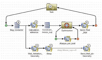

This Isight workflow, with an embedded Abaqus FEA loop, allowed the Verallia design team to systematically optimize bottle shape, making slight changes in the bottle’s geometry parameters in each iteration. The automated process shortened analysis time from one week to one hour.

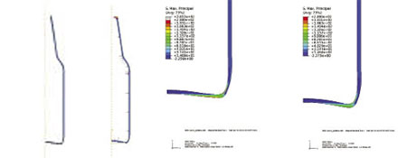

The team started the pressure analysis by first creating a model of a reference bottle in Abaqus: A 2D model using glass’ basic material characteristics was used to take advantage of the bottle’s axisymmetric geometry and save computing time (see Figure 1). They then meshed the model and applied boundary conditions and loads. To optimize the geometric parameters (in this case nine, but sometimes more) that were used to describe the bottle’s bottom—such as internal and external shape, curvature, and a number of different radii—Abaqus was coupled with Isight. This allowed the team to automate the simulation workflow and systematically make changes in the parameters, calculate stresses for each profile, and ultimately determine minimal stress and optimal bottle shape (see Figure 2). “In the case of the hard-cider bottle, we were able to reduce weight by 10% and stress on the critical bottom region by about 17%,” said Brajer. “In the past, it might have taken us a week to run the 100 simulations needed for this optimization. But now with an iterative looped process, it only takes about an hour.”
