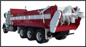

Manure spreaders have a tandem hydraulic pump. One pump drives the beater system at the backend that spreads, or applies, the product onto the field. A hydraulically driven end gate, or tailgate, opens up to allow the product out the backend, and the system also has a hydraulically driven variable speed floor.
An essential function of the control system is to monitor the torque load on the beater. With the beater requiring the highest horsepower load, it is crucial to use a pressure control, essentially a torque control, to keep the entire operation under the maximum load the drive line can handle. For example, if the operator is driving the floor too fast, which increases the pressure, the control system will stop the floor or slow it down based on the load on the beater.
The key functions TRS Systems developed for McKee Ag are auto end gate control, automatic floor control, constant rate functions, and alarms and diagnostics.
Using the end gate auto function, the operator can hit a button and the end gate will go up and automatically stop based on the pressure. The floor auto function works in unison with the end gate auto. When the operator drives the machine onto the field, he can essentially hit one auto button, and the whole machine starts working. The operator can then concentrate on navigating the field and covering it systematically.
The constant-rate feature allows the operator to set the tons per acre and spread width for the actual width of the beater, and the floor will be controlled automatically.
