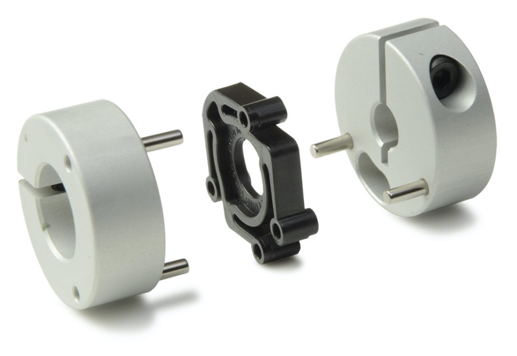

Controlflex solves three specific encoder application requirements that our standard beam couplings do not.
1. First, Controlflex couplings have speed capabilities to 25,000 rpm in contrast with our standard beam couplings rated to 6,000 rpm. Of course, other beam couplings on the market are rated to 10,000 rpm … but these can be insufficient, as there are plenty of encoder applications that operate to 10,000 rpm and beyond.
2. Controlflex couplings can fit into confined spaces with a length-to-outer-diameter ratio under 1:1. Even in single-beam couplings — a standard style of encoder coupling — the ratio normally tops out at 1:1. Tight envelopes are common in encoders because mounts are often custom built … leading to a lack of standardization. Designers are usually trying to keep them on the shorter side to reduce the amount of misalignment. This can result in an unusual sizing relationship between the shaft sizes and coupling envelop requirements.
3. Lastly, Controlflex couplings come in myriad versions — including those with dramatically different bore-size combinations. At Ruland, our beam couplings usually have a large-to-small bore size ratio of 2:1. It’s not uncommon in an encoder to have a large motor shaft (such as 20 mm) connecting to a small encoder shaft — such as 8 mm, for example. Our standard beam couplings cannot accommodate this drastic step in shaft sizes. That’s because when we designed the beam coupling line, it was meant for encoders and light-duty servo applications … which meant we had to be able to maintain torque transmission throughout the bore range. Such large steps in shaft sizes made it challenging to rate the coupling to our desired torque level, because it would overcome the clamping force on an 8-mm shaft.
In contrast, Controlflex can handle a large-to-small bore ratio of up to 3.5:1 depending on the outer diameter size. This gives designers a lot of flexibility when selecting an encoder to attach to their motor.
Ruland is distributing Controlflex, which is manufactured by Schmidt Kupplung in Germany. We have had a long partnership with Schmidt, who owns our German distributor Orbit — so it made sense to partner on stocking and reboring Controlflex couplings.

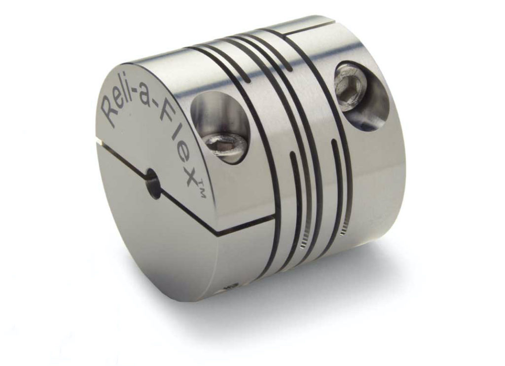

What new support are you offering to laboratory automation or other industries that require small and precise builds?
Slit couplings are our newest addition and fill four existing holes in our product range. They have small bore sizes down to 1.5 mm. These sizes are common in scientific and analytical equipment. Nothing in our standard product range fits sizes that small.
These new slit couplings also have speed capabilities to 70,000 rpm. Such speeds are common in those small shaft sizes … though even the larger bore sizes that cross into our standard size range have higher rpm options.
Thirdly, these new slit couplings have moderate torque and high misalignment capabilities. We don’t have another standard coupling that satisfies applications with parameters that fall between those that suggest the use of bellows or disc couplings and those that suggest the use of beam couplings with low inertia. After all, bellows and disc couplings are high-performance couplings that have limited misalignment capabilities. Aluminum beam couplings have limited torque and high misalignment capabilities … and stainless-steel beam couplings have high inertia. The high inertia is not desired in most motion control systems.
Slit couplings have torque capabilities comparable to those of stainless-steel beam couplings but with better overall misalignment capabilities.
Lastly, our new slit couplings can fit in confined spaces and accommodate all misalignment forms. Currently, the only product we sell for high torque in tight envelopes is a single disc coupling. They have no accommodation for parallel misalignment which causes problems if misalignment can’t be precisely controlled.
Our slit couplings are manufactured by Reliance Precision in Ireland. Reliance is well known for building precision assemblies and assisting companies with their designs. They have been using Ruland couplings as one of their standard options for many years.

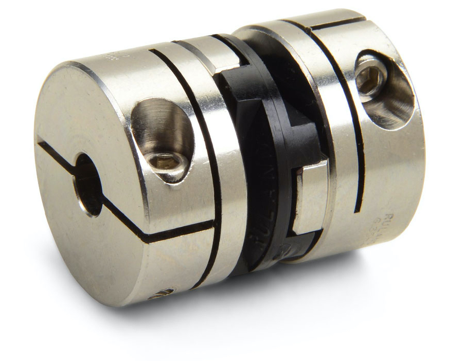

Do any of your couplings go into food and beverage machinery subject to washdown?
Stainless-steel Oldham couplings were recently added to our standard offerings because they address three design challenges our other couplings do not.
1. Stainless-steel Oldham couplings are suitable for food processing and packaging applications that may experience washdown. Our other coupling styles use aluminum as the base material. The exception is stainless-steel beam couplings … however, these are not a corrosion resistant coupling. The standard hardware is alloy steel and will rust which can lead to failure.
2. The stainless steel Oldham product line has a stainless steel screw giving it consistent corrosion protection. Second, they can be used in high temperature applications. When combined with a PEEK disk they are capable of temperatures up to 148° C far surpassing anything else in our standard product range.
3. Lastly, stainless steel Oldham couplings excel in applications where low outgassing is required. Two caveats: This does require the use of a PEEK disk … and the end user may have to change out the standard screw (which has a proprietary anti-galling coating) depending on the application.
