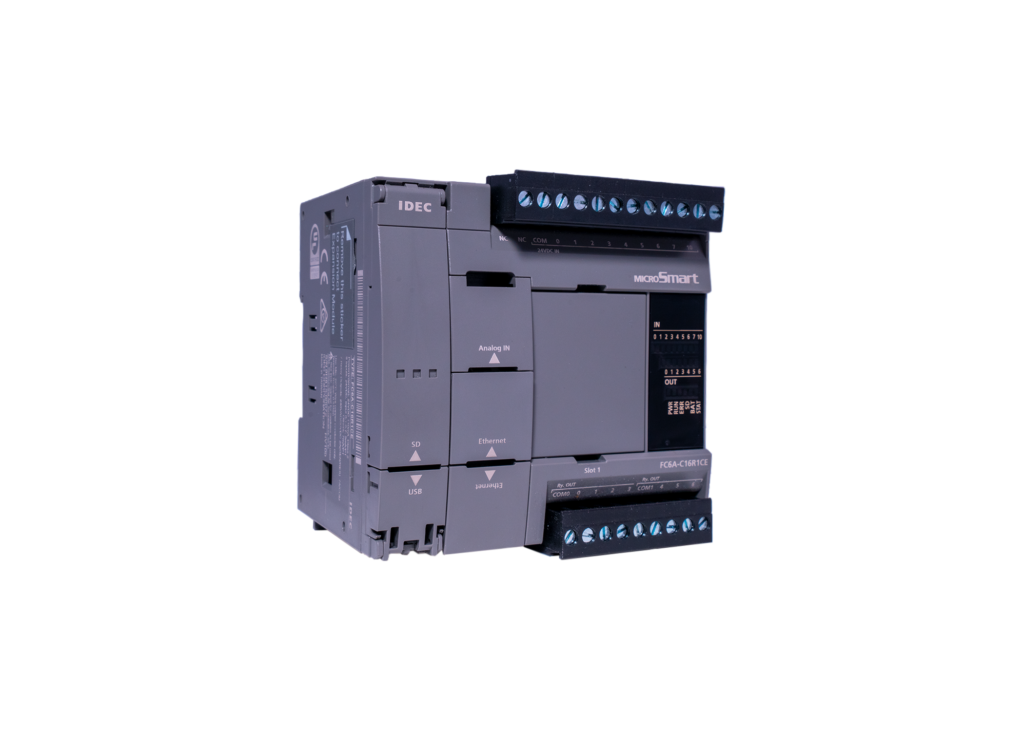

When choosing a PLC for a 12 Vdc application, designers need to ensure the device can withstand the environment, provide sufficient I/O, and support the necessary communication and visualization requirements (Figure 1). Following are some of the capabilities designers should investigate.
Most lower voltage PLCs will already have a relatively small form factor, which is a plus for remote and mobile applications where space is often at a premium. But these installations also tend to be located in environments that can become extremely hot or cold, or where high vibration is present. Selecting a device with the widest possible operating temperature range is a must, along with proper resistance to shock and vibration.
For applications where combustible gases, vapors, or liquids may be present, designers should look for devices carrying a Class I Division 2 rating as an indication of suitability for hazardous locations. For oil and gas installations this is obviously important, but in actuality many types of automated equipment may be used in and around hazardous locations, for example many types of water treatment.
Defining the I/O count may seem straightforward, but a common issue for automation projects is the need for additional future I/O as requirements expand. This is why modular designs are preferred to provide options for configuring the PLC initially, while providing options for future growth.
Communication protocols enable a PLC to talk to intelligent field devices, to other PLCs, and to supervisory systems like human-machine interfaces. Most PLCs are Ethernet-capable now, and Modbus TCP is among the most common protocols. However, it is also helpful if the PLC can use serial Modbus RTU communications to access legacy devices.
One last look
A final concern when selecting a 12 Vdc PLC solution regards what operator visualization is needed. This is often a requirement, with needed functionality varying widely. In some, no visualization is needed once the PLC is programmed and commissioned. Sometimes a small local HMI module is sufficient to let users access important values. In other cases, a full-fledged local HMI display needs to be installed in an easily accessible area.
More advanced applications might need web-viewable visualization and connectivity. In these cases, choosing a PLC with web server capabilities allows it to host web pages, which can be accessed by any device capable of hosting a web browser, such as a laptop, smartphone, or tablet.
Some PLCs can even initiate emails for warning or reporting purposes, often a necessity for monitoring remote unmanned locations. If the PLC includes an SD memory slot, users can store data on the SD card and transmit it as needed.
One other capability can be a great advantage for mobile applications which may not need full-time visualization. Some PLCs can interact with iOS and Android mobile apps over Bluetooth. This means users can connect their mobile devices wirelessly, without opening any enclosures, when they are near an automated installation. These apps let users monitor the system, change parameters, or perform other control tasks, such as uploading and downloading programs or data. This can be an ideal way to provide essential visualization right when and where it is needed.

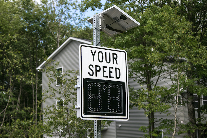

Because solar power generation performance has increased and prices have decreased, there are many applications which can be purely solar-powered. A typical installation can be powered solely from photovoltaic solar panels when the sun is shining, and by a battery bank in other conditions. The battery bank receives a trickle charge from the solar panels, and it can operate for years with little or no maintenance.
Using solar/battery technologies, many types of traffic controls such as speed indicators and crosswalk warning signs can be installed on a single pole without requiring any external power or other connections (Figure 2). This makes it very economical to install them wherever they are needed, even if other infrastructure is unavailable. Integrating 12 Vdc PLCs with these systems is a compact way to obtain the necessary functionality. In addition, these PLCs can be connected to nearby wireless networks for sending information to the cloud or for receiving remote instructions.
