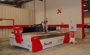

Semyx LLC out of Dalton, Ga., creates custom machines to meet the waterjet cutting needs for a variety of industries, from metal and stone to food and textiles. Semyx is the
only OEM that designs large, custom waterjet cutting machines for companies around the world.
only OEM that designs large, customized waterjet cutting machines for companies around the world.
